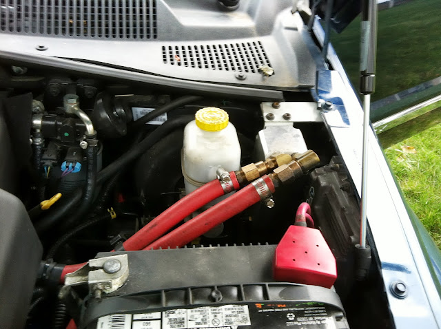

I'll consider reinstalling it after seeing what the actual separator is that the PO used. It looks like it is mounted/housed in a homemade aluminum mount, so I can't get a good look at it from pictures. At purchase inspection the mechanic said they couldn't determine a brand because it wasn't labeled (I don't know how hard they looked).
If anyone has any ideas what I have, here's a pic:

I have no idea what you have. But now i know why you want to remove it prior to inspection. Sure dose not look like a OEM install. The inspector would red flag that for sure.
I would take it off and leave it off. It dose not look like the hoses are large enough. My provent hoses are 2x them.
