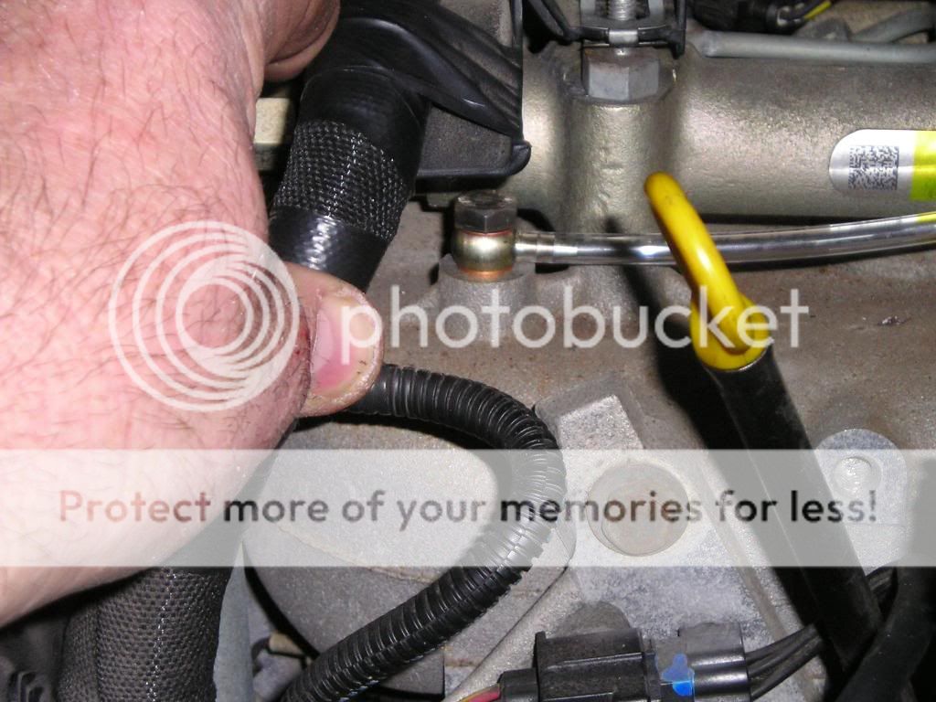

How I did it. Fuel injection Banjo fitting, home made banjo bolt. I greased up the drill bit, drilled the hole into the manifold and attached the boost line. Simple.

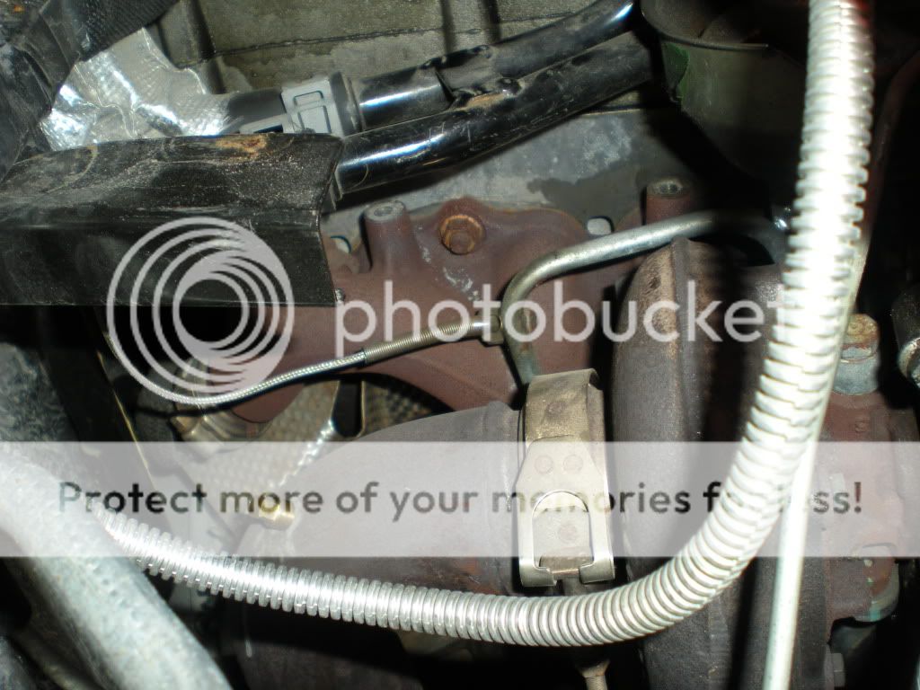

EGT probe location, I packed the drill and tap with grease to keep the chips out of the manifold:

You have another probe location on the downpipe? How come?
I was thinking about that, but I went a different route: I welded a metric nut (M10 IIRC) to the outside of the turbo's manifold inlet, then drilled through the center so the probe could sit in the dead-center of the entire exhaust flow.
Rough guesstimation is that I read about 300 degrees higher at the inlet than someone reading post-turbo... But I don't know. At cruise today, 80mph (GPS) on flat ground it was reading about 775*F all day long. Slightly slower speeds (also at steady cruise) seems to consistently read about 700.
How about yours?

geordi wrote:
You have another probe location on the downpipe? How come? First location of probe, later it was used for the pressure tap to measure back pressure before and after replacing stock muffler and getting rid of the choke point on the cat rear flange
At 80 MPH I am watching for cops and tend to drive closer to 65-70MPH. Since my prob is in the manifold runner instead of the turbo flange, I tend to read 850f to 900f at flat ground 70MPH. I would read lower if I took the tools out of the back.
