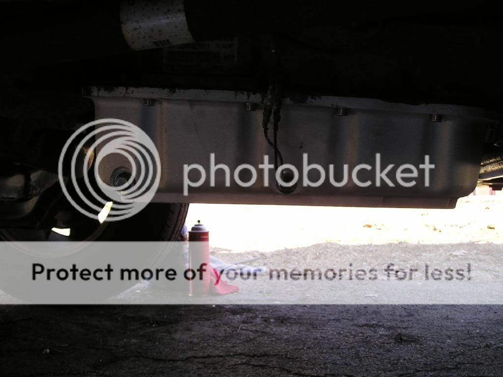

Trans temp gauge is another good option. Here is the probe on my PML pan.
With the Extra Deep PML pan the warmist my trans oil has ever gotten was 180f and that was when I was stuck in a crawl and stop traffic jam in 95f+ weather. I have never gone over 140f when towing a trailer. Only draw back of the PML Extra Deep Pan is that in sub zero weather it will take up to five miles of driving on the tollway to get my torque converter locked in fifth.
