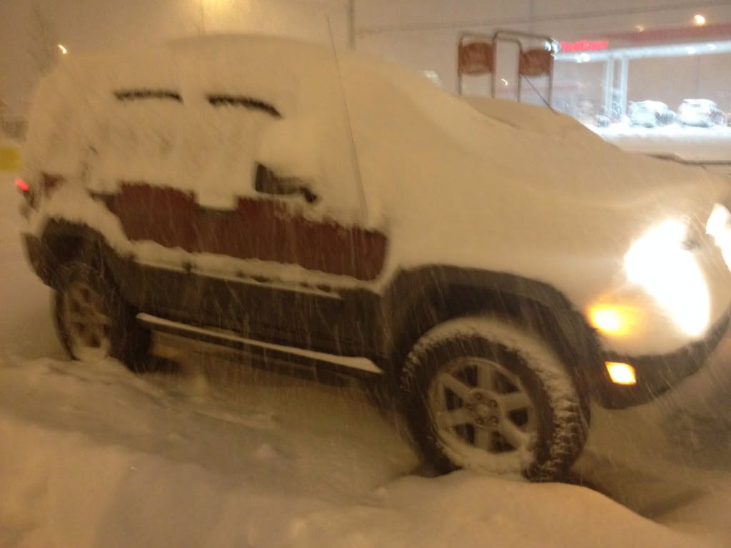

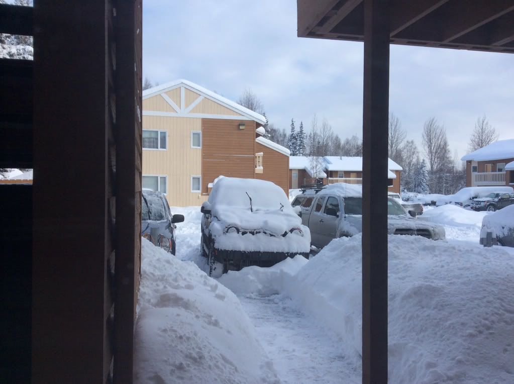

Cherrie 274 wrote:
Might consider moving after all they had a nicer winter:).
3 hours of snowfall - Image
A brush off then you wake up a few hours later and voila! Image
Be our guest cherries
