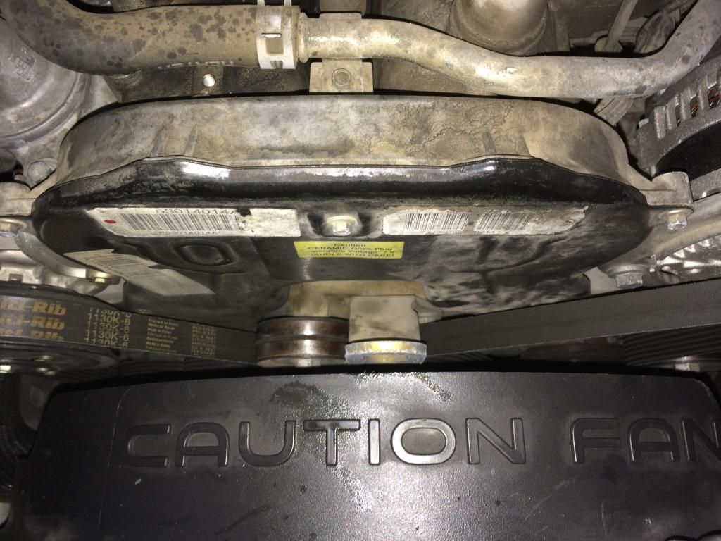

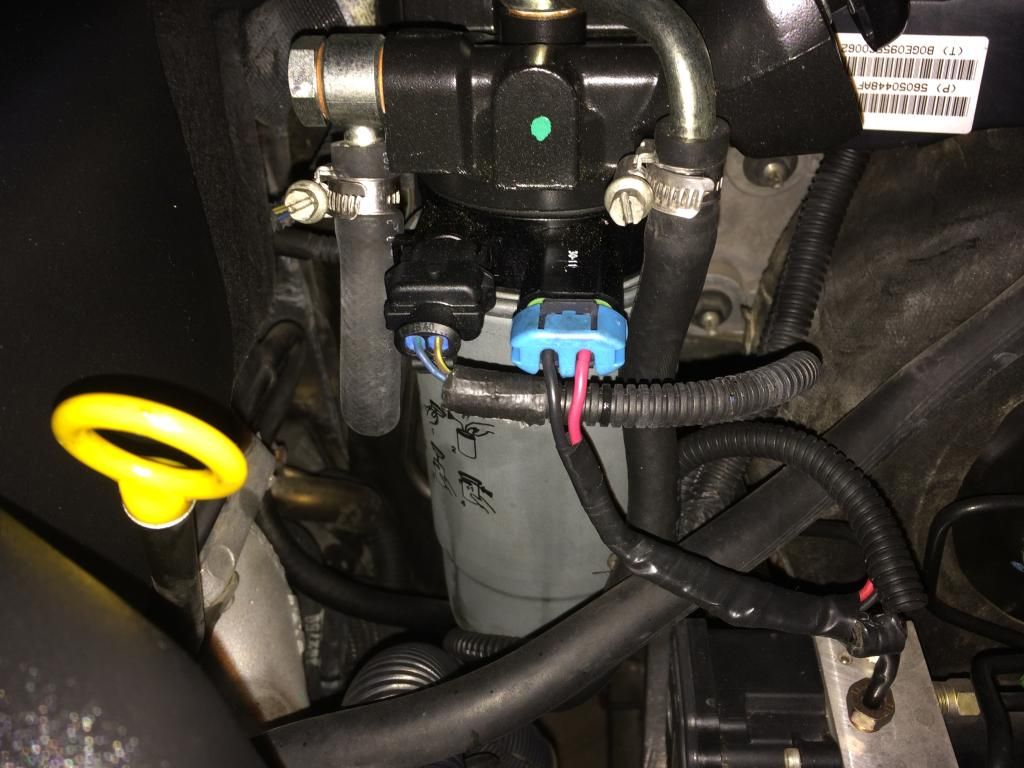

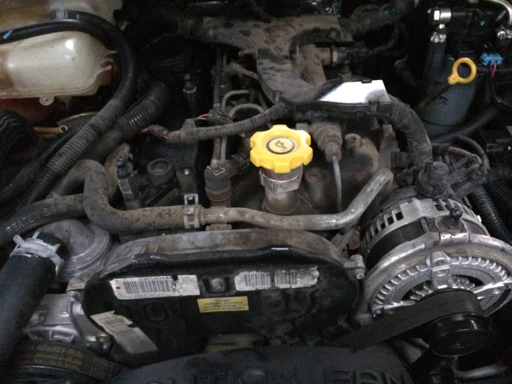

Here's a few pictures under the hood of my newly purchased CRD.
It looks like the fuel filter head was updated. I'm also noticing what appears to be either a very clean relay or a new relay. Don't know. What might be the story here?
2005 Silver Limited Liberty CRD. Purchased with 133k. Rotella T6 5w-40 at Mob1-301. 2nd gen fuel filter head.

Don't know about the relay but that's a 2gen fuel filter head which is good.

Think that might be the glow plug relay

Yes, it is.

If that is a new glow plug relay then I wonder if you have the OEM replacement 5v metal glow plugs instead of the original 7v ceramics. That would be a good thing. As I recall you can tell which glow plugs you have by the color of a band on the top but I forget what color are involved. Should be easy to check on #1 or 2 glow plug but maybe the data from the Dealer will answer the question.
I will be looking into this today while I've got a brisket on the smoker. Looking for a white or red ring on the GP.
I placed an order with GDE for the Flash Tool rental and an Eco Tune. If I understand what I've read on GDE's forum, its necessary to tell them if I have the 5v or 7v glow plugs so the PCM tune is set up properly.
It is very important to update the engine PCM tune prior to connecting the new glow plugs. If not, the metallic plugs will be supplied with too much current and overheat. GDE has updated tunes available for any customer wishing to coordinate the hardware and software change together. The other option is to have the dealer flash the PCM with an updated stock tune. Then we can work out the details of having the GDE tune reinstalled using our flash tool loaner program. - See more at: http://www.greendieselengineering.com/j ... qRIzX.dpuf

Yes GDE will need to know whether you have 7v or 5v glow plugs. Hopefully you will find one or the other colored ring and/or the dealer info coming in the mail will indicate if the 7v ceramics were replaced with the 5v OEM metal ones.
I strongly suspect that you have the 5v OEM metal ones based on the PN on the Bosch part (0 281 003 034) and the fact that it's nice an clean. If you Google that # you get viewtopic.php?f=5&t=57915&start=20 which has a picture of the 5v "kit" including the controller.
Yes I know there is a lot of discussion about what controller is used for the 7v vs 5v glow plugs and some indication that it's the same Bosch PN and that may very well be the case as my controller has the same PN and I have 7v glow plugs (the Italian drop in ones not ceramic). However, the fact that you have what looks like a brand new controller strongly suggests recent glow plug replacement.
If you don't find a colored ring or get info from the Dealer you may want to contact Kieth at GDE about how to test for GP voltage.
