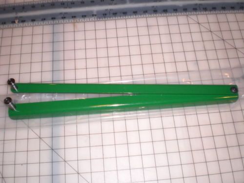

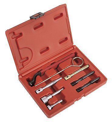

I'm looking to see if any community members have the VW sprocket buster tool and the Sealey cam crank timing took kit available to a fellow member for a timing belt replacement.
I'd cover the cost of anything that breaks, shipping both ways, and something for your trouble and my gratitude.

Unless there is a member close to you, I think you're looking at about 40 bucks in shipping only... Your call obviously, I'd just buy the parts. The vw sprocket tool you can make yourself with 2 3/8 or 7/16 grade 8 bolts and some 1/8 metal, I made it myself for about 15 bucks from home Depot.

Yeah... But that green one is so much sexier and professionally powdercoated and all... :)

That green one is purdy for sure....
I hope someone hooks you up, would make for a few less steps for you.
If it doesn't don't despair. I actually just went through this. I had ID parts toss the metal nerd tensioner wrench in the box for $24, made the sprocket tool for about $12 with a 3' chunk of angle and some nuts and bolts. I did the beesville farm pins for the cams and a drill for the crank pin. With a bench grinder and calipers the pins were easy to make. Finding 10x1.0 bolts was a bit of a pain. Ended up re-threading 1.25 pitch bolts (that worked) since I didn't want to make a second trip to my not-exactly-local Fastenal.

I went ahead and placed an order for the tools.
After I'm done with my project, if anyone else needs to borrow them, send me a PM. I'll have the pin set and camshaft sprocket buster.
