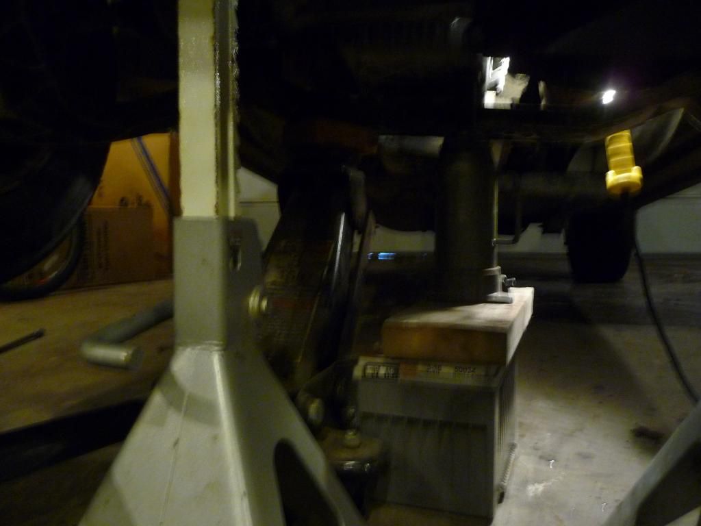

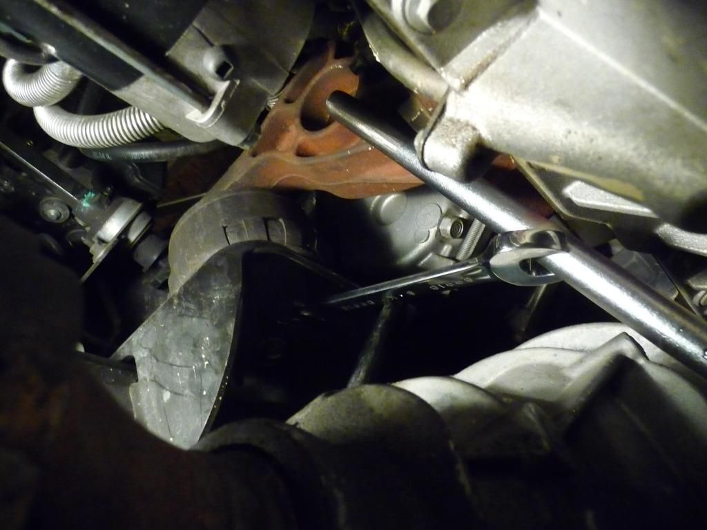

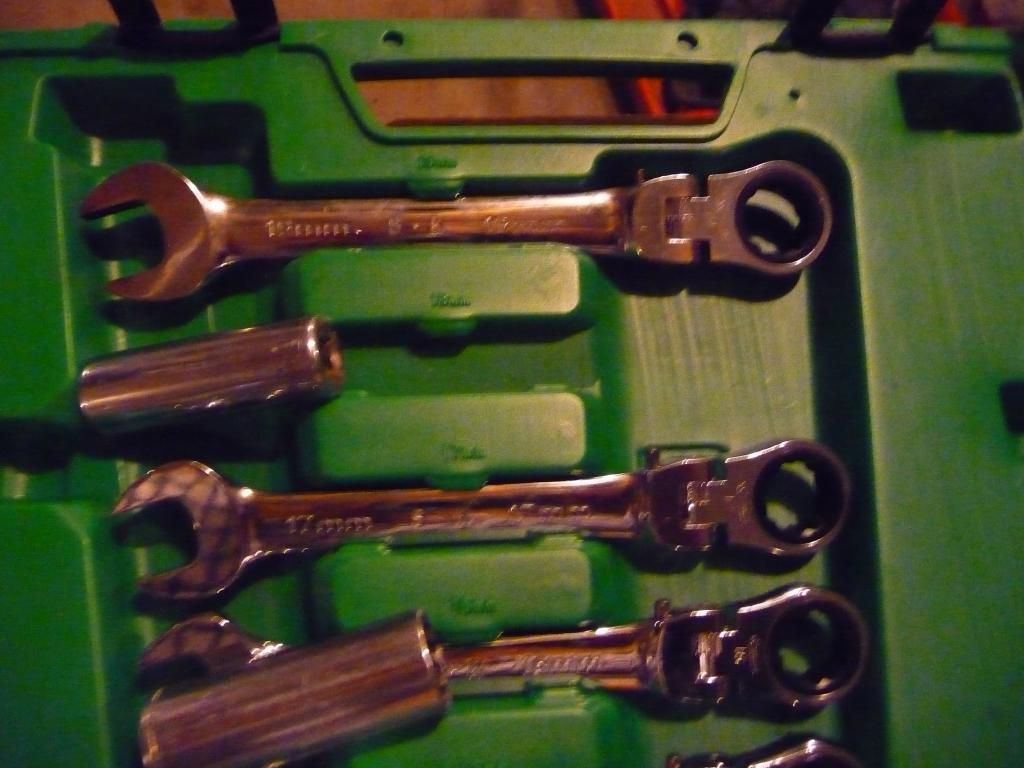

Drive up on ramps. On the driver's side, take out the battery and battery tray (three nuts on tray). Remove intercooler to engine hose (CAC?) I have since been informed that a person does not have to remove the battery tray or CAC hose, you just need some extensions and joints. Undo the top nut on the mount. Jack up the vehicle as described above using the floor jack. Use jackstands! Underneath the engine do yourself a favor and get some ratcheting swivel head wrenches (Photo A) Place the ratchet head on the lower nut and swivel to allow swing. Use a bar to pry against the motor mount bracket with one end, and the other in the open end of the wrench and turn the nut loose (Photo B). After a while you will be able to just use your ratcheting wrench to remove the nut. Use the bottle jack arrangement described above (Photo C) to gain clearance on the motor mount and once the mount stud will push out through the bottom mount bracket(up), go to the top and finagle it out. Place in new one and go backwards sentence by sentence to put back together.

Seriously buy some swivel ratcheting wrenches, I use mine all the time.

Photo A
Photo B
Sorry it's blurry, I was kinda in a hurry. It's 30F some degrees.
Photo C
Laying on my back under engine compartment, right behind the front wheel. Aluminum looking thing on right is the motor, mount looks good..... :ROTFL: Ratcheting wrench levered with pry bar on motor mount bracket (rusty thing)
