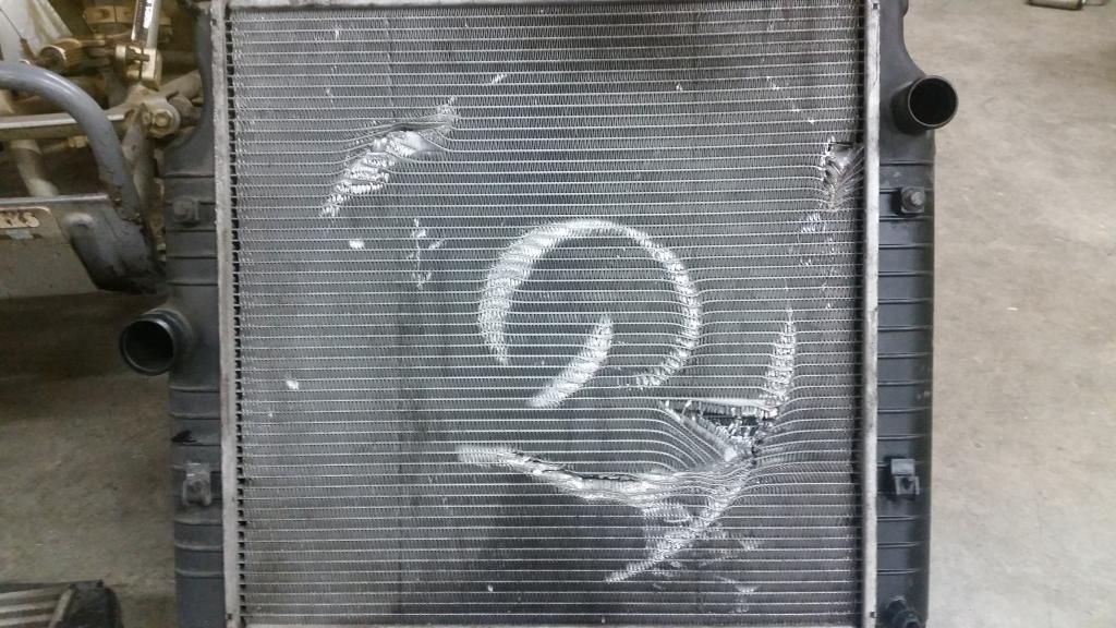

CRD05il wrote:
gumbygoose wrote:
Having to do some accessory drive work on the GF's crd. Belt was original and coming apart. It had a squeak and bearing growl. The fan clutch had been locked up for a while taking the shaft and bearing down with it. I inspected the decoupler pulley on the alt, it is fine. One idler growls a bit, and the other has a slight catch. i have a new fan clutch, idlers, and fan pulley assembly on the way. My problem is that i can not find just the tensioner pulley. The tensioner itself if fine. If anyone has any insight on a part number, or a replacement would be greatly appreciated.
How did you inspect the decoupler? Because I had the same problem and replaced my tensioner first and the noise came back after a few days. It was the decoupler. Because mine looked great but then I took it off and it fell apart.
i took the cover off to look for the red dust from the clutches, and didnt see any. i also spun it with a drill(a old burn off wheel attached to the drill), then grabbed the pulley while my roommate see if the shaft spun while the pulley was still. He claimed to see slight slippage.
But now ive got bigger issues. On my way to the P.J.O.C. (paducah jeep owner club) christmas dinner tonight, the fan bearing finally let go and went into the radiator. So now i have to get a new radiator, fan blade assembly, and shroud.
I am having a difficult time finding the metal fan. Ive been looking on moparpartsoverstock.com and moparpartsamerica.com
Found a radiator and shroud on rock auto.

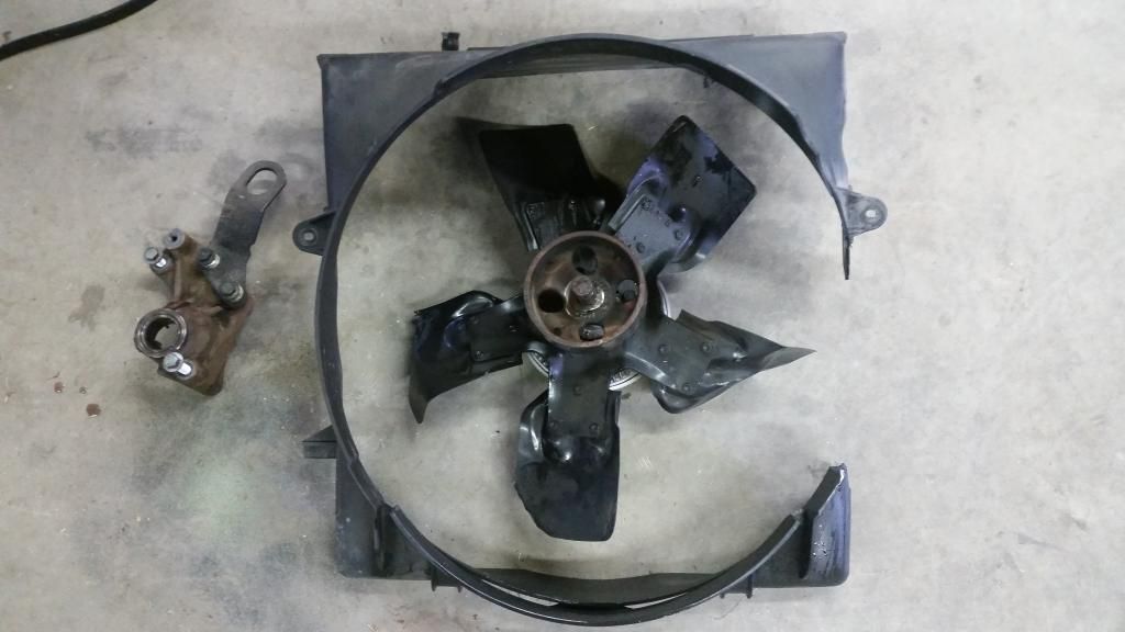

 Post subject: Re: part number for tensioner pulley
PostPosted: Fri Jan 02, 2015 10:12 am
Posts: 627
gumbygoose wrote:
This is the mess im dealing with at the moment.
Seeing that makes me want to go out and remove my fan this very second.
PostPosted: Fri Jan 02, 2015 10:19 am
Posts: 5431
Based on your picture of the fan shroud it looks to me like both mounting bolt tabs are intact as is the top of the shroud with the possible exception of a bit of the edge just above the right mounting tab. If that's the case my advice stands; just cut the shroud just below the other mounting tab; ditch the entire bottom part; install only the top part and you will be fine. NOTE be very careful to reuse the current shroud mounting bolts or if you misplaced them do some careful measurement for replacements; length of these bolts is critical as too long will puncture the radiator.
PostPosted: Fri Jan 02, 2015 12:40 pm
Joined: Fri Dec 26, 2014 1:36 am
Posts: 80
Location: west Kentucky
I'm particular about bolt placement. When I take a part off, I take the hardware and put it back where they came from.
I'm going to just return the wrong shroud and do like you said, just cut the original one.
