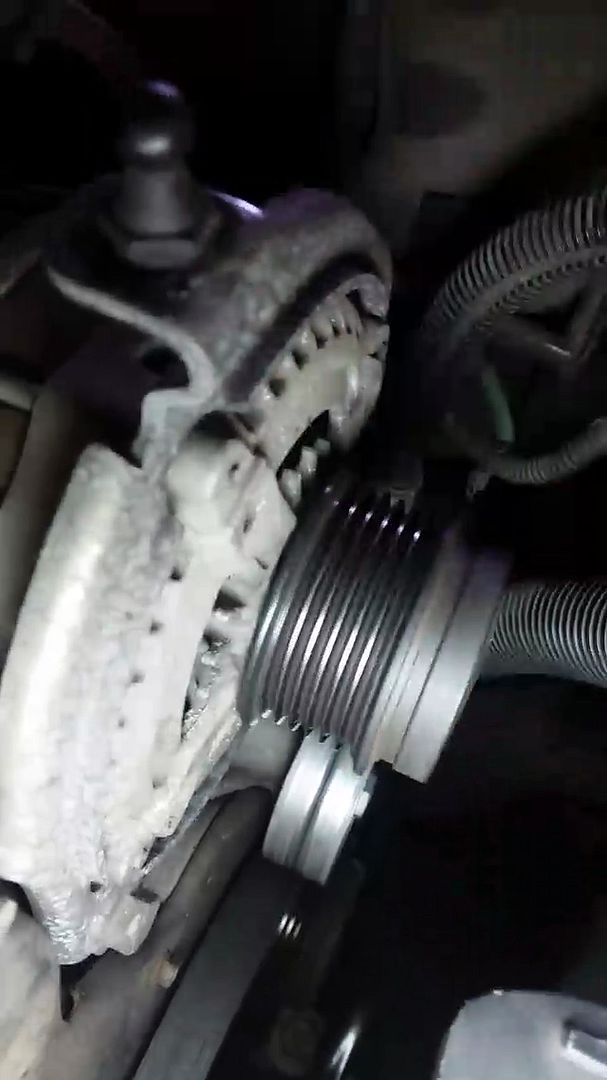

Here is the pic with the lisle set that I used for alternator pulley:
Seems to be the same as idparts sells.

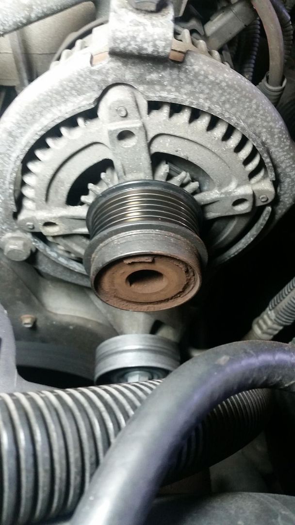

Took the belt off and spun the alt pulley.
Video below
Yea that's toast.

Yep that's one of the better pictures of the red dust on a bad alternator pulley.
FYI all the KJ CRD thermostats come with 2 plastic ports except Kap's and Turbo-diesel-freaks after market ones. The plastic ports are pretty solid at least I've never heard of one breaking except if you try to remove one from the housing.
