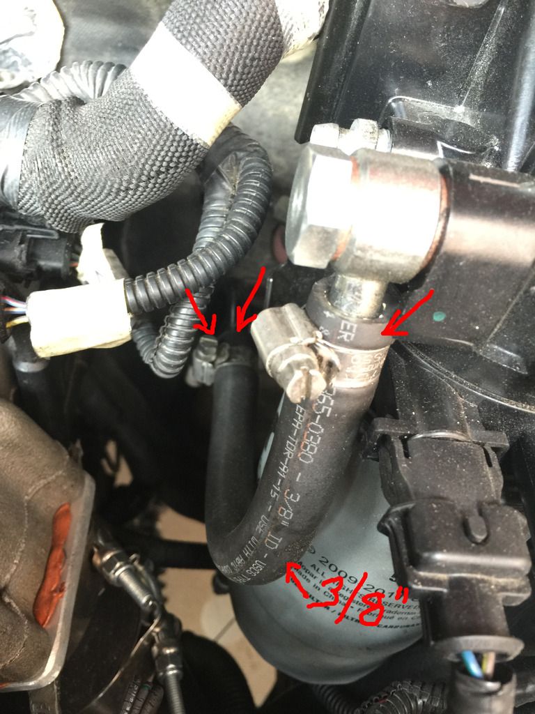

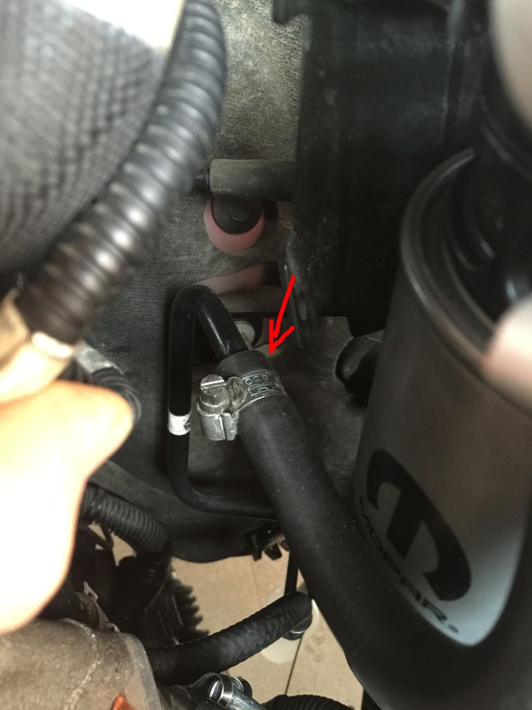

I didn't mess with undoing the crimp
I just used a small pipe cutter to cut the crimped end off completely.
Then just added my own 3/8 fuel line with new hose clamps.
In my case, the original rubber line was rubbing against a bracket and almost wore completely through.
Also, back at the tank, there is a coupling in the fuel supply line between the plastic line from the tank and the hard line on the frame. I cut that coupling out and replaced with 3/8 fuel line and new hose clams.

pjigar wrote:
Yes, but start from a crimped fuel line going from metal fuel line to fuel head, as I said. This one is easier to replace. The fuel head need to come off. Also replace fuel line going from fuel head to CP3 pump as a cheap insurance. If this does not cure then move to the tank (which is a lot of work to drop).
When you say
, Do you mean the line going to the fuel pump on the engine, coming from the fuel head?
If I understand correctly, you are saying to cut out that supply line, and replace with 3/8" biodiesel grade rubber held by worm gears.
The coupling you refer to, will it directly support having a 3/8" hose directly connected? And is the hard line okay to attach3/8" hose over and clamp?

 Post subject: Re: Fuel Issue: need ideas
PostPosted: Tue Aug 25, 2015 10:40 am
Posts: 4962
Yes.
I just slipped 3/8 fuel line over the hard lines and clamped.

flash7210 wrote:
Yes.
I choose to un-crimp the hard line because there is a little bump on the fuel hard line which allows secure connection. Notice the bump just ahead of the band in this picture:
This is the first line you should start with. Next is the line going from the fuel head to the CP3 pump.

pjigar wrote:
flash7210 wrote:
Yes.
Oh, that is perfect: thanks, fellas! I have the Jeep up on stands now, and am calling a taxi to get me to the auto parts store...
