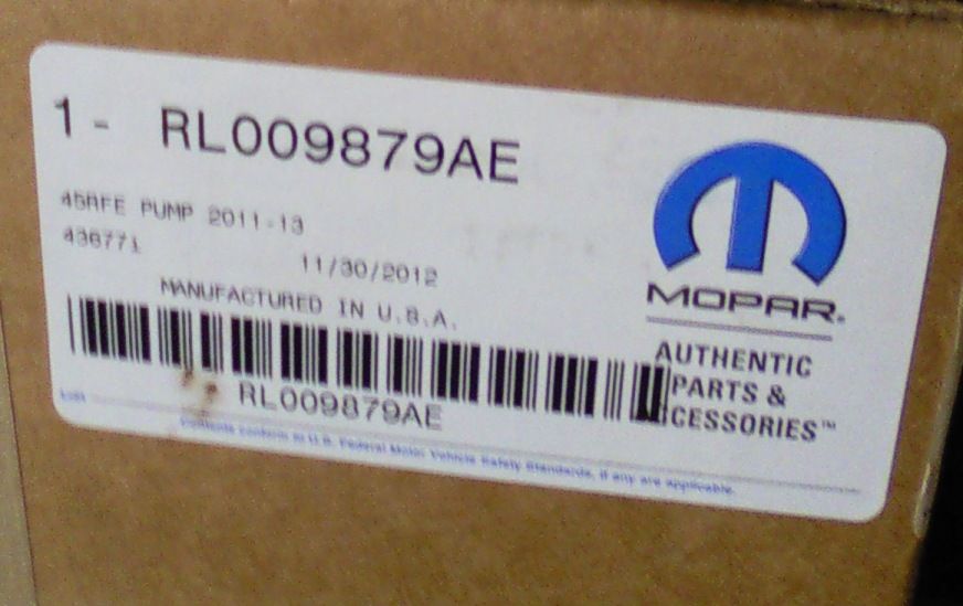

I was in a similar situation as you. (Trans out and no real reason to replace the front pump) I did end up putting a new pump in and it has been working great. Here is what I ended up getting form the dealer, they are re-manufactured pumps.
Phil
