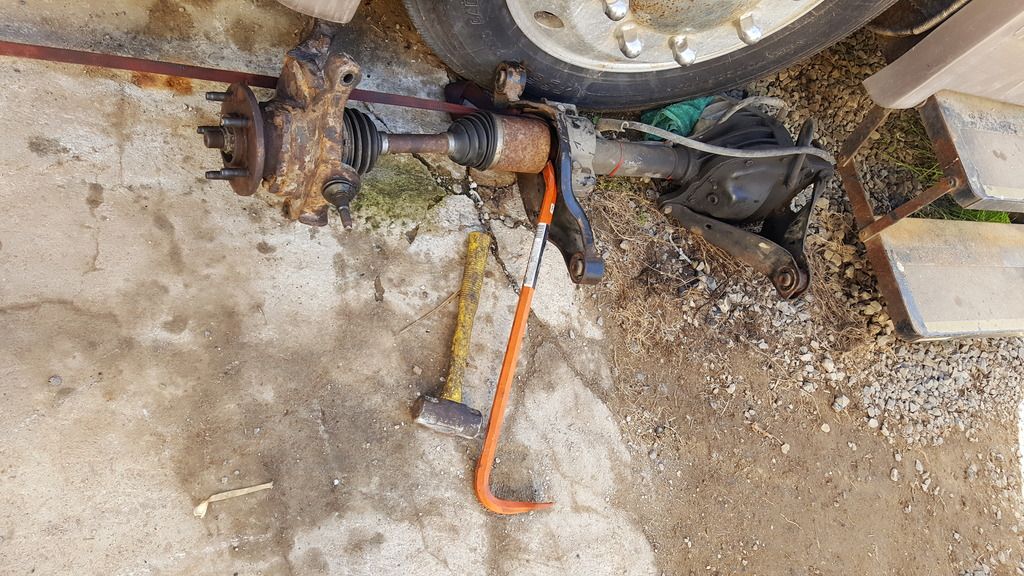

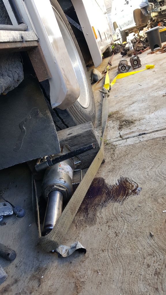

Submitted for your amusement: field-method for separating stubborn right half-shaft from diff, my RV providing the best anchor;
And in the other corner, weighing in at 20-tons:
To the jacknstraps, add sledging on crowbar and STILL won't separate!
Unfortunately, the Gasser's hub lacks the ABS sensor of the CRD, therefore I can't just swap the whole hubnhalf-shaft assemblies.. Now I've gotta' pull the half-shafts out of the hubs to keep the ABS'd hub with the CRD.
More fun!

 Post subject: Re: Releasing front-right half/shaft from ARB'd diff?
PostPosted: Thu Nov 24, 2016 8:53 pm
Posts: 2523
Location: LOST in Wisconsin
Wow, That looks stuck.
You are fighting two spring clips on either end of the half shaft. Maybe driving it back into the diff and trying again may re-positioning the spring clips and allow them to compress as you pulled out the axle.
I ran into improper sized spring clips on every replacement axle I've ever installed, way to big and would have to be forced in. I can imagine that they would be a bear to get out. I always replace them with new factory clips.
2005 CRD "Ol' Blue"

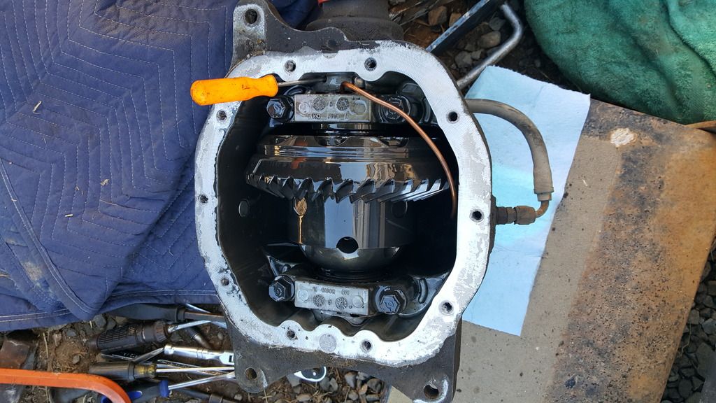

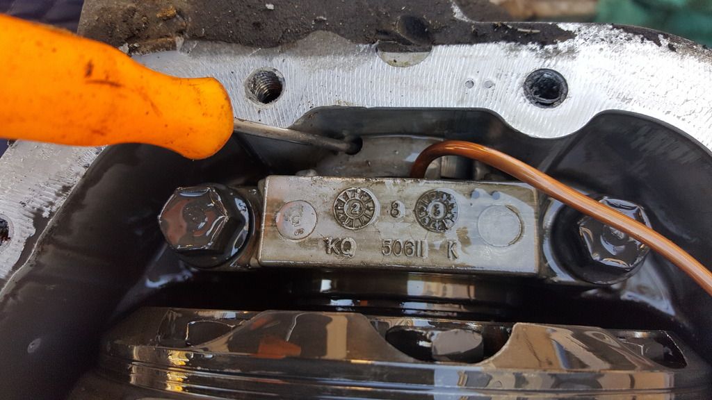

Hunting old threads, this:
"Axle Shafts
Chrysler 8.25" C-ClipsThe Chrysler 8.25" uses c-clips to hold the axle shafts into the differential side gears. Limited clearance between the axle shaft c-clip grooves and side gears can make c-clip installation and removal difficult. When c-clip installation is difficult, selecting thinner c-clips should allow easier future removal. ARB Air Lockers actually come with multiple c-clip thicknesses from which the installer can choose.
Yukon manufactures 30-7/8" 29-spline c-clip axle shafts, specifically designed for the Jeep Liberty's Chrysler 8.25" rear axle. Made of 1541H steel, they are 25% stronger than the OEM shafts. "
In any event, I was unable to get the ARB'd half-shaft's spring clip to release using the 'ole in-out, and the (sideways) pic below shows the cover off the ARB front diff. The orange pick is poked through a hole that may provide access for pressing on the spring clip, but I couldn't get it to cooperate:
Luckily I was able to coax-off the 37/38mm half-shaft nuts with a 6-point 1.5" socket. Gratefully, they cooperated out of the hub.
The battle rages on
