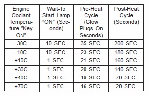

GP's operation according to the FSM (factory service manual) below:
Please keep in mine, some say the FSM is NOt correct on this time table. :banghead:

Mine really likes her glow plugs, even at warm outdoor temps when the engine is cold. How to tell? Go straight from off to crank like a gasoline engine and she'll crank and crank before starting. Wait at "run" for 30sec and she'll usually start right up.
It was worse when I had the 7v steel plugs. Especially below 30F. They liked 3 cycles like my old Mercedes diesel did at 0F (key to run wait 30sec, key to off, repeat then crank after 3 cycles) and she still had a bit of a long crank. At 90F she starts pretty much as expected. (get in, turn to run, put seat belt on, crank) I ended up putting Bosch 5v steel glow plugs in and it starts a lot better at colder temps.
Try cycling the key 2-3 times (waiting at run for 30sec each time), if that makes a big difference you probably have 7v steel glow plugs and they just take longer to heat up. If they're blown I think it will usually set a code. It might be worth changing them out for Bosch 5v steel glow plugs just to be safe, as the original 7v ceramics worked great but could break and destroy the engine.

What I usually do is to turn the key to run, wait for the seat belt chimes to stop, switch off, then repeat the process if it's particularly cold out. At as low as 0°F I may need to do this up to three times before starting, but it always seems to work. The only real cold-weather starting issues I typically have are if I have a brain fart and just turn the key with the engine completely cold, forgetting to pause for the glow plugs to warm up. That usually happens at least once per Winter.

YOU DO NOT WANT TO CHANGE THE PROGRAMMED VOLTAGE.
This is important - you WANT the 7 volt software that you have currently. If your CRD still has the original glow plugs, you want to get them out of there, the ceramic plugs are known to fail and when they do, they can throw ceramic shrapnel into the cylinders and cause severe engine damage. Some have had the ceramic manage to escape the cylinders without causing damage or be smashed to powder and blown out... But I wouldn't want to trust fate like that.
When replacing the plugs, you want the 5V bosch metal plugs from IDparts.com as they will start great with the "voltage mismatch" and will NOT be damaged by that. There are people going on 4 years now with the plugs set up in this way.
