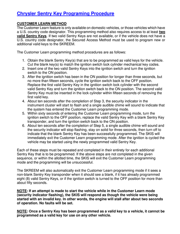

You can purchase a spare key and have it programed by a dealer or any good certified locksmith.
Once you have TWO valid keys, you can use the self program feature to program a third key yourself. See below:

Several years ago, I purchased my spare key fobs off Amazon and they programed and worked perfect. I am still using one of them to this day.... :wink: :D

I took the new blanks to a local hardware store, they had a key machine and cut the keys for me.
I then programed the chip using the method I posted above. :wink: :D
