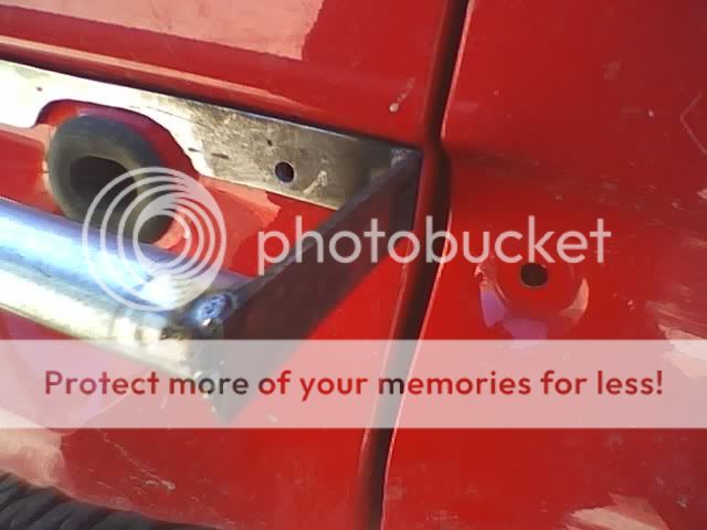

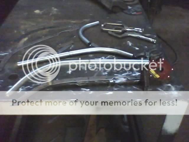

OK, Rescu2000, I like your rear bumper by the way. Here's the first 3 pics of the base for the rear flares. The first one is the rear door, yes, I found a mud puddle yesterday!. I only have the top part done so far, still have to bend the bottom part to match the body lines and weld together.
Next is the back half, I had to notch out around that black rubber plug (not sure what it's for yet but I'll figure it out) . I will be installing rivnuts in the factory pushpin holes to bolt them in to. There is no real way to get to the back side to put nuts on and just use bolts.

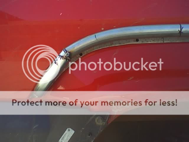

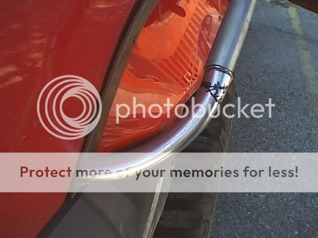

This is a pic of both halves just kindof held on with one bolt each where I could get to them. Was able to balance a nut on my finger and shove it in the hole ... :shock: ... :roll: ... (That's what she said) :ROTFL: and then screw a bolt in for the pictures.
They will mimic the lines of the front flares at the bottom and at the rear. I decided to make them almost full flares VooDoo. I will split them at the door. I hope this will turn out the way I see it in my head. If not, I'll cut 'em up and start over. At the rear they will turn in and meet the body just ( 1/4" ) above the rear bumper. This should allow me some flexibility when ( if ) I get around to making a rear bumper. This is a slow, time consuming, custom, hand job. Any more fab work on the next set of fronts has been put on hold till I get these done. 8)

Exactly, In the 3rd pic you can see where the split will be. The ends will be flat stock. It looks like at that point on the fender they will be out 3 1/2".

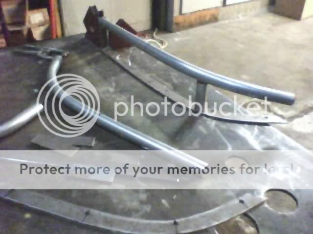

So I laid some of it out today and tacked it together, then took it out and held it up to the KJ for pics. Just the rear portion of the rear fender.
Terry, you want just the base pieces? Whatcha gonna do? Steal my business? :lol: J/K, If that's all you want we can talk and figure out something for that. You still got your towbar attachments? Maybe we can work something out for a full set?
