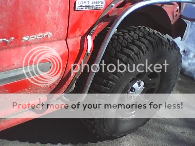

Well it's been a couple days and some but not a lot of progress. This is where I was at
It's looking pretty hacked up now. It's been apart and retacked together 5-6 times now! :furious: Part of it is like 2JeepFamily said trying to keep the warpage to a minimum is almost impossible now. :banghead:
So I made a new template and cut the flat piece from a single piece of .125 sheet steel. I am programming this into our laser so it can be duplicated exactly. The main piece is identical for L & R sides as is the curved piece at the bottom.
Then I bent new pieces of tubing for the outside curves. I made 2 identical pieces like this for the main Wheelwell opening. It's just the curved pieces on the ends that attach to the fender are opposite.
So that's where I stopped today. I think maybe I was getting in too big of a hurry before and wasn't thinking it thru completely that led to me having to cut it apart and redo it so many times. I'll keep working on it a little at a time tho' and keep taking pics. :lol:

Once they are done in a couple weeks they will be skinned with sheet metal. The goals of all this are: to open up the wheelwell, eliminate the plastic flares and add support to the outer edges of the flare. I used electrical conduit for the mock-up because it's easy to work with but the finished product will have a thicker tubing on the outside edges that hopefully I can lean on just a little bit.

Here is the finished frame for the right side. I didn't even have all the bolts in and I could grab it and rock the KJ! :)
Now it just has to be skinned with sheetmetal.
Whadya think so far? :?:

Looking good Larry! Patent those before someone else does!!
