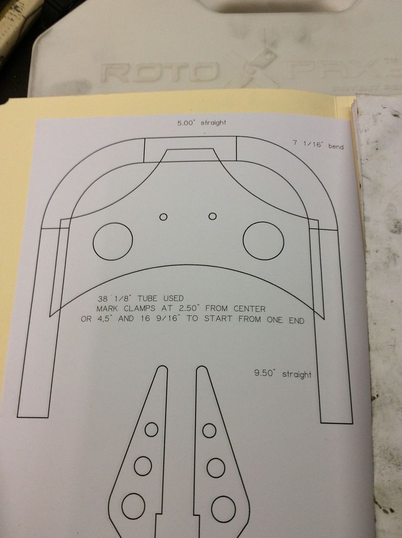

Finally got my hands on some RotoPax cans and mounts for some mock ups... Something I've been wanting to offer for a while now.
Custom mount for a tire carrier swing arm. Those likely won't be the ones I'm using for the production version, instead they'll look like the one in the paper drawing.
Also finally in the home stretch in getting the new production KK racks worked out. 3/16" plate sides, extra tie down points, six 1.25" crossbars. Still figuring light and accessory mounts out. Terrible pics I know, it was freezing outside and I had been working outside all day.

Wow.....love that carrier!!! Will you sell those separately for people who wants to upgrade?
Thanks Ricky
Like just the Rotopax mount? Yeah I don't see why not....if the person is able to weld it on.
