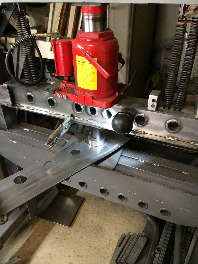

Hmmmmm miscalculated 100k lbs of pressure it seems. :banghead:
I destroyed part of my press using it to dimple 3/16" material. The I Beam I have between the jack and punch for the dimple die buckled on the web and deformed the bottom flange. I patched up the buckled web to keep on truckin' for now but you can still see the bent flanges. Had some 1/4" plate burned out to build a proper beam for this 8)
Not finished quite yet

Much stronger now.
