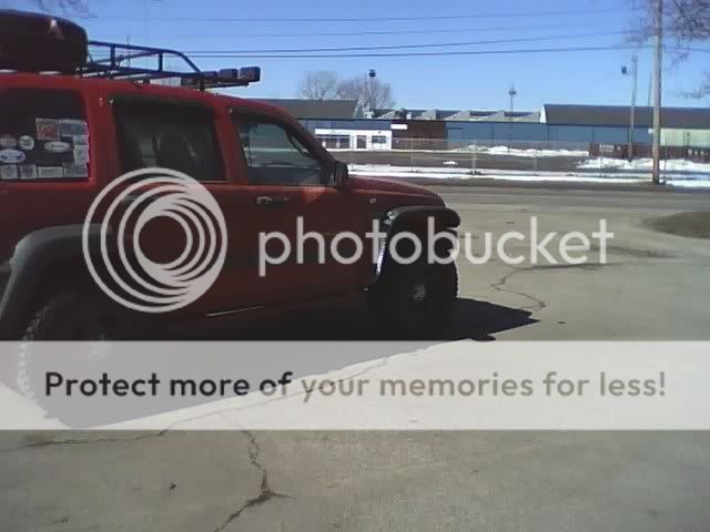

Went in to work and did some more to the fenders today. Found some "scrap" sheetmetal (at least it was once I got ahold of it! :-)r ) and started welding the skin onto the flare. It went better than I expected. I think they are beginning to take shape now. Only had my cellphone with me, hope these are okay for you guys!
Side far view
Closer at about 45 deg.
Back about 45 deg.
View from behind
view from staight on
The ARB guys keep talking about the advantage of being able to set tools or whatever :5SHOTS: on their front bumpers, so... here's one for them! :goink:
I still have finish work to do on the right one and then weld up the left one ( I have most of the pieces cut, bent and shaped ) but they are coming along nicely.
Anybody wanna buy some flares? $750
J/K THESE ARE MINE! :BANANA: (maybe, cash talks !!)

KJWildman, Very nice! Flat fenders do make a excellent cup holder! Woohoo! Can't wait to see the back ones!

Larry they are lookin awesome :BANANA: even better in person I must say, the pictures don't do them justice :JEEPIN:

They look alot better than I could have ever imagined!!! I am kind of a purest when it comes to the liberty I like the fenders that are on my Renny but I could see a set like that on it!!

My question is this,
what can be done about those (now) unsightly INNER fenders,
can they be cut out some, or are they structural.
because if they are not structural, you have opened up a whole new dimension of tire sizes for us KJers!

Spray it ALL with bedliner.... Bedliner fixes anything and hides a multitude of sins!!!

Most of what's left (on mine at least :wink: ) is structural or support for other body pieces.

Sorry it took so long, the 3/4" wide piece that bolts to the body is 10ga. and the sheetmetal on the fender itself is 16ga.
Just ordered a full sheet of each today, 48 x 96 , should be able to get a few sets of these out of that once I get my fixtures made. Anybody interested? I know, :roll: you'll have to see them finished. Hopefully I'll have the first set done completely and on for the Badlands Run on the 3rd. :BANANA:
