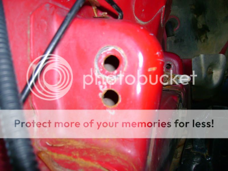

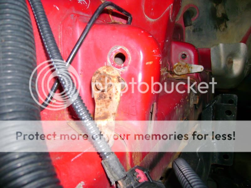

Yes, while I have the engine out I am doing a cradle drop! :twisted: I contacted Marlin about his UCA drop mounts but he wouldn't sell them alone without the entire kit. So I did mine without the extra brackets by actually lowering the Upper A-arms and customizing my new trans mount. I installed the spacers and then to keep the stock geometry of the suspension within specs I had to move the mounting location of the upper arms. By using dial calipers, level and machinist square, marking carefully and then double checking everything I have accomplished it! This would really not be possible with the engine in place due to having to be so precise in the measurements and drilling of the holes and there not being a whole lot of room to lower them to begin with. Since I (we) welded new motor mounts and customized the trans mount it also made it possible to keep everything aligned as far as driveline. I am also having to REALLY open up the A-Arm pockets and weld in new bracing for the opening to allow for the extra droop. Anyone who has had problems with their arm hitting the bottom of the pockets can confirm the lack of room there. That part of the project is almost done now, so I can go ahead and continue on with the rest of the installation of the engine soon!! :BANANA:
So to sum it up, with my well used suspension, 3/8" clevis and 3/8" top plate, if I had the stock fender flares on it, my measurement is now at 26" center of hub to bottom edge of the fender flare. With MY fenders ....... I actually have 29.5" to the fender! :pepper: Now I may have to figure out how to get another inch or two in the back!! :banghead:

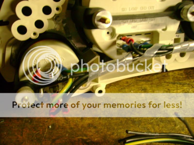

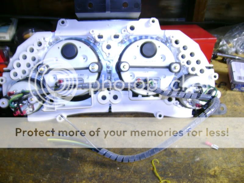

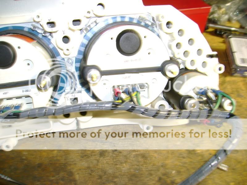

Worked on the dash cluster again today. Mounted up the turn signal and hi beam LED's behind the stock cluster so they show thru the factory indicators, also got a few more orange LEDs so doing the overhead lights, fog lights and driving lights and the 4 lo indicator. Not doing any red idiot lights, I have gauges for oil pressure, water temp, trans temp. Going tomorrow to get the new torque converter bolts and transmission case to block bolts and I'll be ready to slide the engine in! :BANANA: Maybe in the next week or two it will be in, then work on welding in rad mounts and engine compartment wiring.
