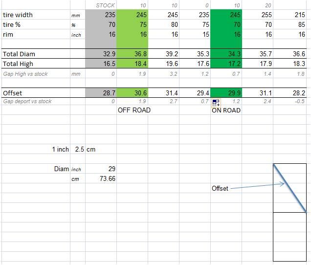

i thought i would put of ol onthe fire since i was passing by.
I actually build a small xls table which gives you the exact diameter and radius and moreover the "offset" of a tire.
I think that the offset is the dimension that really tells if a tires will rub or not... :banghead:
i defined the offset by the diagonal , blue line on the drawing that reperesent a view of the tires from the front (or rear)
As you see, a 215-85 R16 has the same offest that stock tires ==> No rubbing
But it is 0.7 inch (1.8 cm) higher in radius ==> 0.7 inch lift....
...but you know what? i still think the option of ridding on high and narrow tires (to avoid the rubbing) is ...crap....stability must be bad and if the tire is slightly soft....then it is even worst.... :jester: I am pretty sure that people racing invented low cut tires for a reason... :seuss:
by the way, let me know if i can put the xls document on the site. it is quite usefull. i will make an inch version for you guys..
