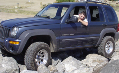

My dealer said it was cool too...I guess. Welp, pics first:
Skyjacker lift and 245/75 16 MT/R's.
As we all know (or should), there was a recall on ball joints. I skipped that and kept going. About a month after that pic, I went in and put on new MT/R's and did an alignment. They mentioned the joints looks a bit sloppy, but safe for now. A week later they dropped out. Luckily I wasn't on a highway. Anyway...
I went in to a dealer here in Folsom California and they did the Recall repair. New ball joints, new halfshafts, new fender flairs and liners...the works. No charge. I can scan and post the repair bill because I saved it all this time. I'm still shocked actually, but it's my turn to get lucky I figured. It's been almost a year I imagine, and everything is still tight under there when I did another alignment recently. It's only 2.5" inches.
If you get around to doing a lift, watch the backspacing on those Ruby rims. I went with 4-1/4"(?) on those M/T rims and that profile will hit that little plastic nub at the back of the wheel well. I cut it off, then bent over the lip weld. A little resin and line-x and you can't tell it was there...no rub w/ 31" and a little work.
Oh, and it has better clearance than the ruby too. Just not all the cool toys underneath from the showroom floor:
I'll get some updated pics if you need them. I can guide ya through a lift on the KJ as well, so just holler!
