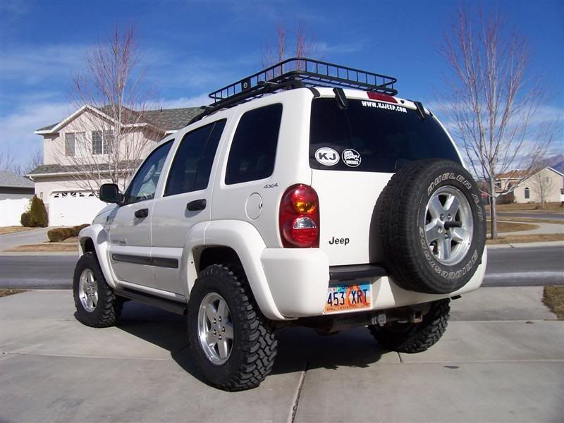

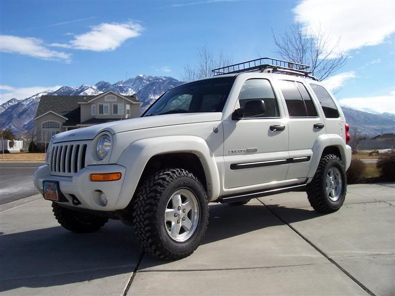

This is what it should have looked like from the factory.
Oh, so THAT'S why everyone pounds down their pinch welds!
I really need my RL front bumper...or at least I need to cut the existing bumper and wheel liner out.

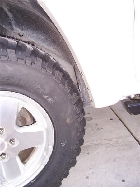

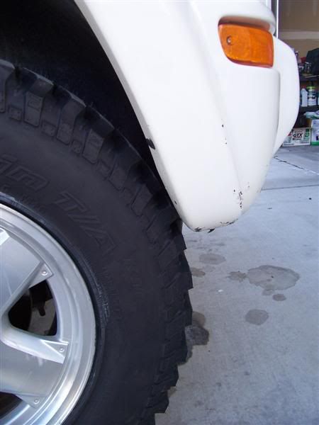

I have to say that, although I LOVE the way these tires look with the spacers, I didn't expect the impact the spacers would have on rubbing. I mean, I assumed there would be some, but I'm making cool noises just pulling out of my driveway. 8)
I'll get it fixed, though. I'll knock down the pinch weld this week, and I ordered a Rusty's air tube so that I can get rid of the stock airbox, relocate my washer fluid bottle, and cut my bumpers, a la Calvin56's post:
http://www.lostjeeps.com/forum/phpBB3/vie ... bumper+cut
I figure I may as well, since I've beaten the crap out of my bumper already, and I'll be replacing it with a RL bumper some time in the next few months.

Do you have a lift on that? I tried reading your sig but, I'm jeep slow. Looks great by the way.
PostPosted: Mon Feb 12, 2007 12:49 am
Posts: 816
Location: SLC, Utah
Yeah, don't try to read my sig unless you have some time.
RRO Combo lift - 2.125" Works beautifully for a pre-lowered KJ. If I were lowered, I'd have gotten a Rusty's coil lift or Frankenlift.

I guess your spidertrax are what's causing the rub on your pinch weld. I only rub on the front bumper doors with my 245/75's.
No, it's my spacers. The tires rubbed very little before I put them on. No worries--I just need to cut away some useless plastic. 8)
