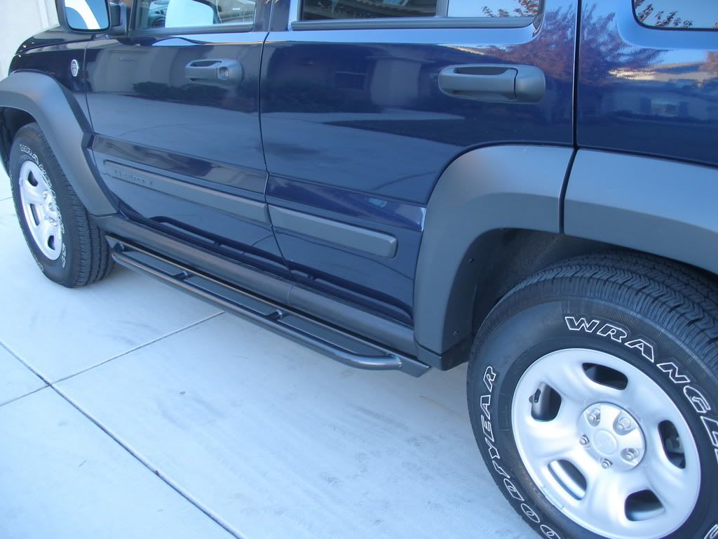

Results -- Bottom line up front:
I really like the look of these sliders on my Liberty. :D

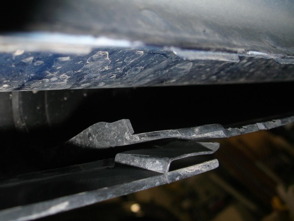

05-06 Rocker Cover Preparation and Trimming:
The RL instructions stated that the plastic rivet on the end may need to be removed – I found no need to remove these rivets and if I had, I’m not sure how I would have reattached the pieces.
The hammer worked fine to pull the panel covers down and a pair of pliers easily pulled the plastic brackets out of the covers or out of the sheet metal – wherever the bracket was left.
I cut the square notch out of the overlapped rocker cover with a pair of tin snips. However the back of these covers also need to be trimmed, so they will lay flat (and thin) against the sheet metal. One side has a tab that needs a razor scraper to shear it off flat. The other has a ridge that needs to be trimmed far enough back to gain clearance for the cover to lay flat when pressed up into position.

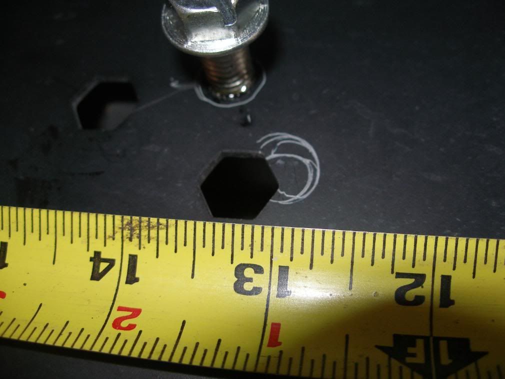

Template Error:
When I put the template on the pinch seam mount I found the holes did not align.
So I flipped the template down on the brace, aligned the center holes, and then scratch a center line on the template in line with the center of each pinch seam mount hole (using the hard tipped center punch provided by RL). Flip the template back on the pinch seam mount with the same center holes aligned and the “scratch” marked side facing the pinch seam mount. Then tape it in place as per RL directions.

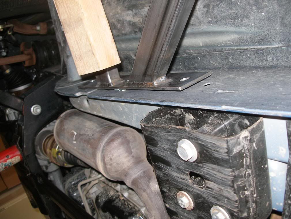

The rails are longer that the flair to flair described but will overlap the flairs – I found the front of the rail to about divide the front flair worked well. However, after I got the pinch seam mount holes drilled on the first side, and placer the sliders up to address the foot holes, I discovered that the “Nutzert” holes on the frame, where the front slider foot rests, is in the same area as the foot’s trailing hole. The hole I needed to drill slightly overlapped this Zert hole. I know RL stated that all bolts didn’t need to be installed, but I drilled another hole in the upper end of the foot so I could have three bolts in. In the picture below, the scratched circles just above the # 13 are from the original foot hole. The bolt above is from the extra hole I drilled. I hit the frame with some brown paint for contrast for the second picture.

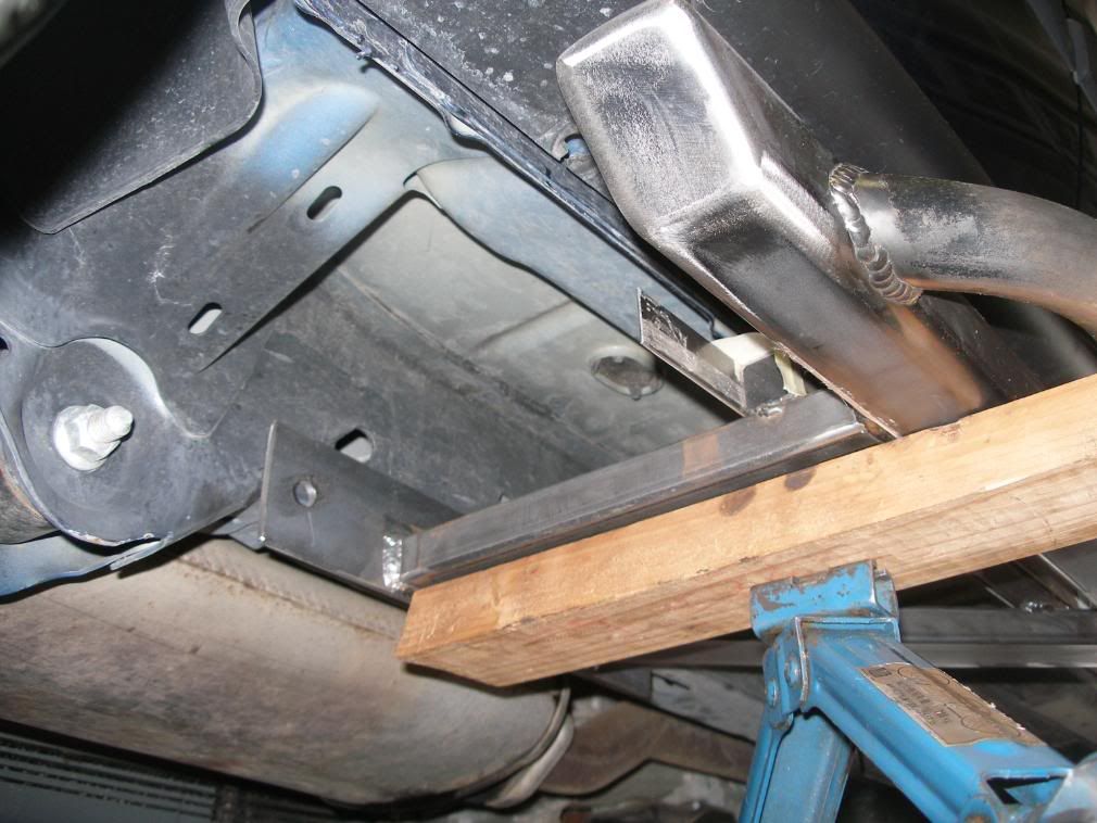

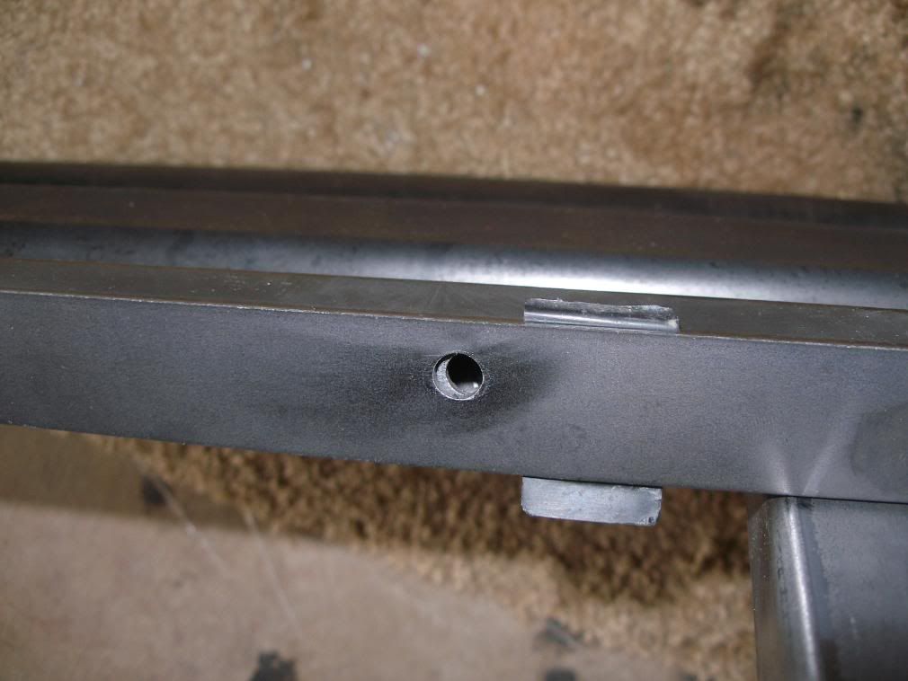

On the other side I aligned the slider a bit forward so the foot’s mounting hole would miss the Zert hole. Image

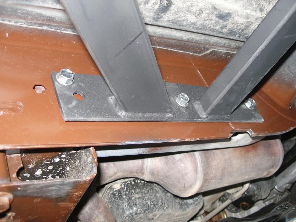

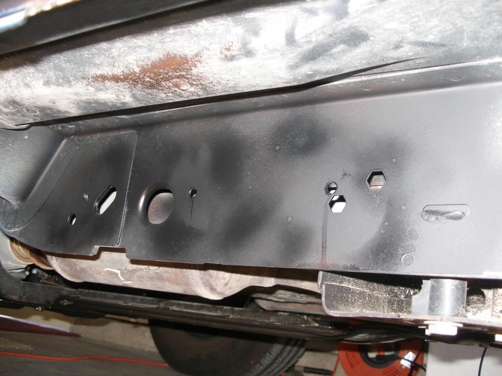

I wasn’t prepared for the foot to not snug up to the frame for each bolt. The frame is reinforced where the ends of the feet set leaving a gap for the other two bolts. I would have liked to have been provided a shim that would slide under the foot, drilled for these two holes and fill the gap.
I did notice that at least one bolt on each foot could be reached inside the frame through holes in the bottom of the frame. If these bolts striped one could likely use a large washer and nut inside the frame.

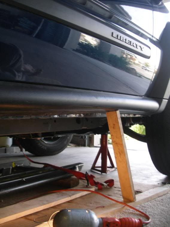

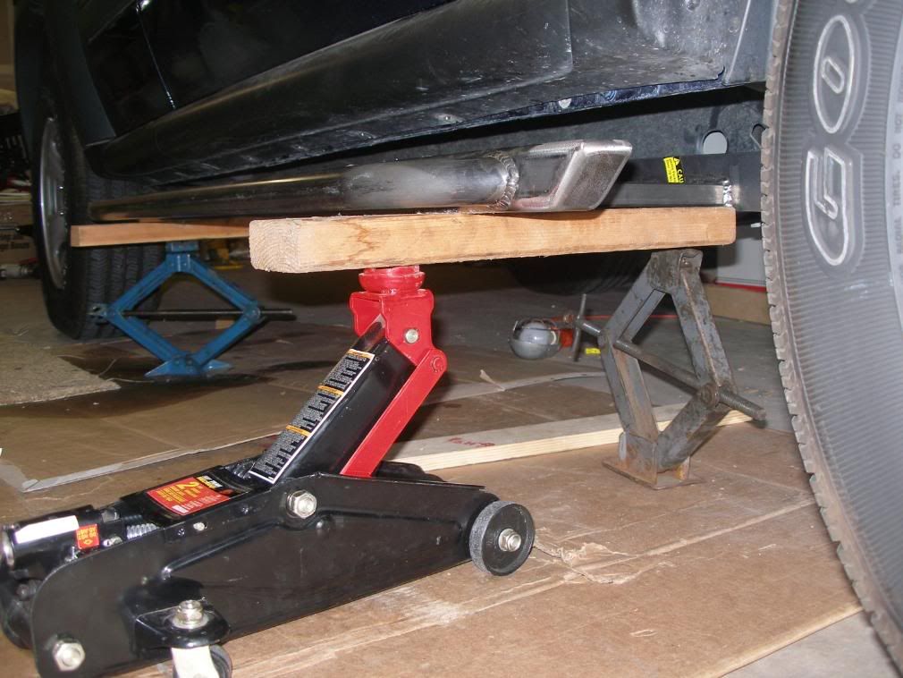

Holding the Sliders Steady:

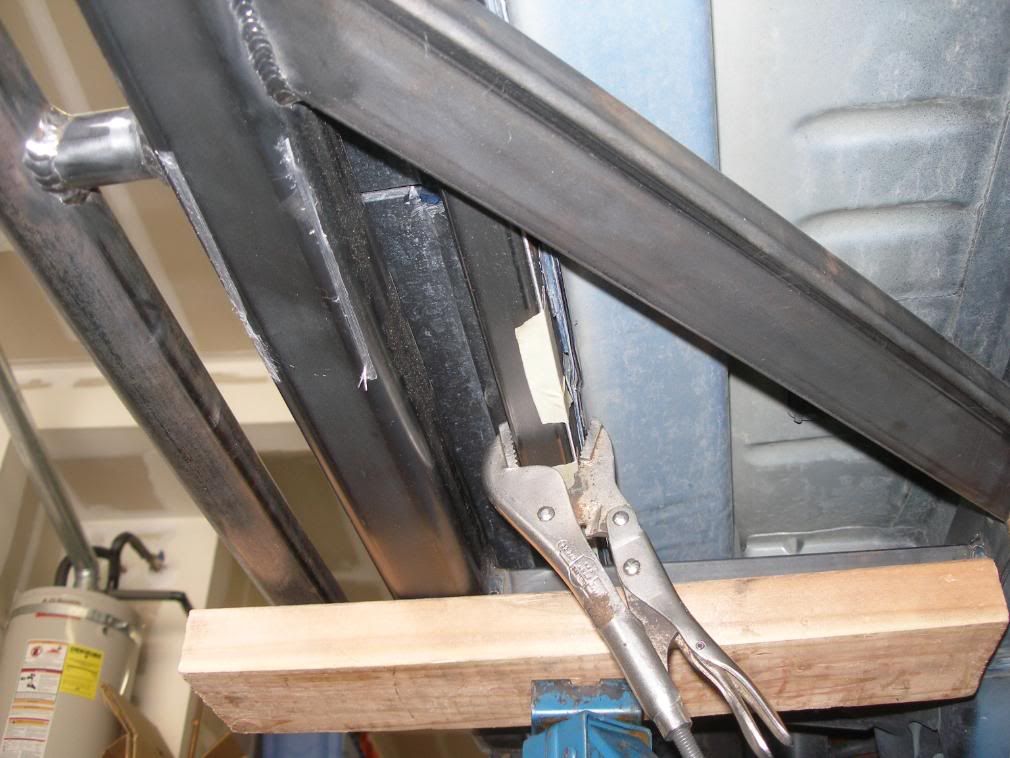

To insure correct alignment, before clamping the template or marking the foot holes, I found it worked best for me to lightly press the sliders and rocker covers in place with jacks. I used two at one end of the sliders to adjust tilt and one at the other end (using 2x4 scraps to protect the sliders). I felt it was important to start with the pinch weld mount as high and tight as possible.
I clamped the pinch seam mount to the pinch seam with vice grips to be sure all was in place before clamping the template to the seam.

I used the recommend Rust Reformer to paint the entire Sliders, it took 1 ½ spray cans. I bought one can each of the Dark Gray and the Hammered Black and then painted each foot of a slider, one color. When dry I held these feet up to the rocker cover to pick my color. The hammered black was my selection. The Rocker Covers were darker and matched the hammered black; the dark gray better matched the lighter finder flares. When painting the hammer black on the sliders I only painted the slider bars and the rock rail’s top, bottom and outside so one can was enough for the whole job.

Did you try the template by flipping it to the other side to see if the holes aligned the other way? They won't align one way but should have aligned the other way.
Also note that we did a comparison on pinch seams, over a year ago, and everyone had different pinch seams. There is no quality control here by DC.

Yes I tried it all ways. The distance hole to hole on the template was slightly less that the hole to hole distance on the sliders – no turning would make it longer.

I wasn’t prepared for the foot to not snug up to the frame for each bolt. The frame is reinforced where the ends of the feet set leaving a gap for the other two bolts. I would have liked to have been provided a shim that would slide under the foot, drilled for these two holes and fill the gap...
I was also surprised by this gap during my test fit. I have an '07, and thought something might have changed since the skinks were fabbed. But, seeing your writeup, I guess that's just the design.
Otherwise, all dimensions and fitment were right on.
