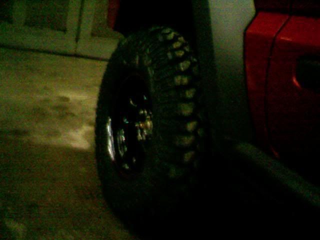

UPDATE... a buddy and i did some light wheeling out in our woods today.. last summer we cut about 2 miles of jeep trails.. here is a little bit of them.
VIDEO-
http://www.youtube.com/watch?v=fJQthKVP ... re=channel
the only trail rash of the day... and neither one of us have any idea how it happened..
well.. i'll have better pictures sometime or another and will update this posting.. but for now sell phone pic's will have to work. my old tires are still available for purchase (in for sale section) if your interested! they're still very nice!

and i used tjkj's experience to find the correct combo :).. 16x7 with 4in BS seems to be perfect. although havnt wheel'em yet.
with my stock alum. wheels and spidertrax spacers they rubbed some but never enough to rip off the fender... would just always pop out the bottom rivit on the door flare... tjkj.. mind showing some pictures of your trimming on the rear? i know there is the metal door under the door flare?

i freaking love those tires. get new pics with better quality! :twisted:

well.. did some wheeling yesterday (pics and video at top) and the tires were AMAZING... the hill at the end of the one trail i could almost never make it up with my old tires.. also i removed the 7 washers i had (per stud) spacing out the back tire carrier because i finally have wheels with the correct backspacing. however they do rub more than my old set up... none in the front.. but they do in the rear a little more.

Personally I think you went the wrong way with wheels. Great choice on tires but not a fan of the black steelies.....sorry. I liked the renegade wheels you had much better. Sweet jeep though I just think with what you have it needs differnt wheels everyone does the black steelies.....

that's true.. but after i sold my wheels,tires, and spacers that put me very very very close to brand new tires,wheels(steelies).. so on my poor college kid budget it was a way for me to get new tires without breaking the bank... however i do love the black wheels... and the correct backspacing made life much easier.
