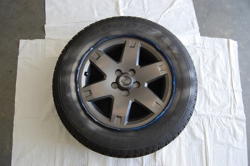

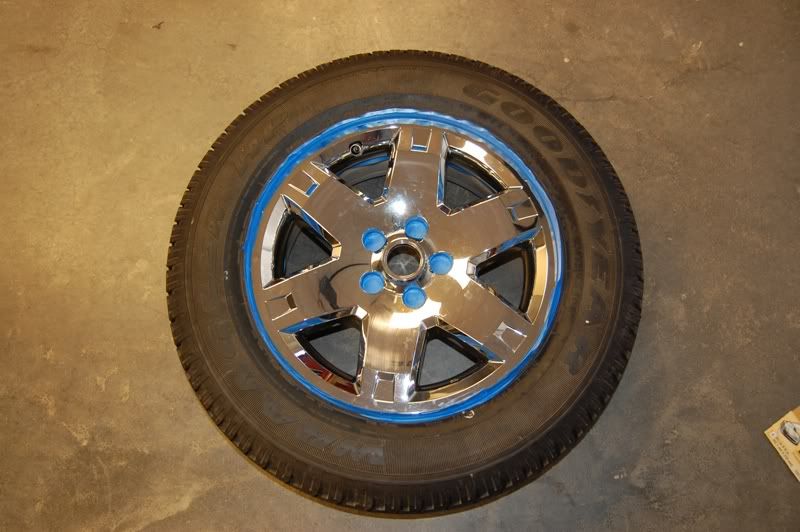

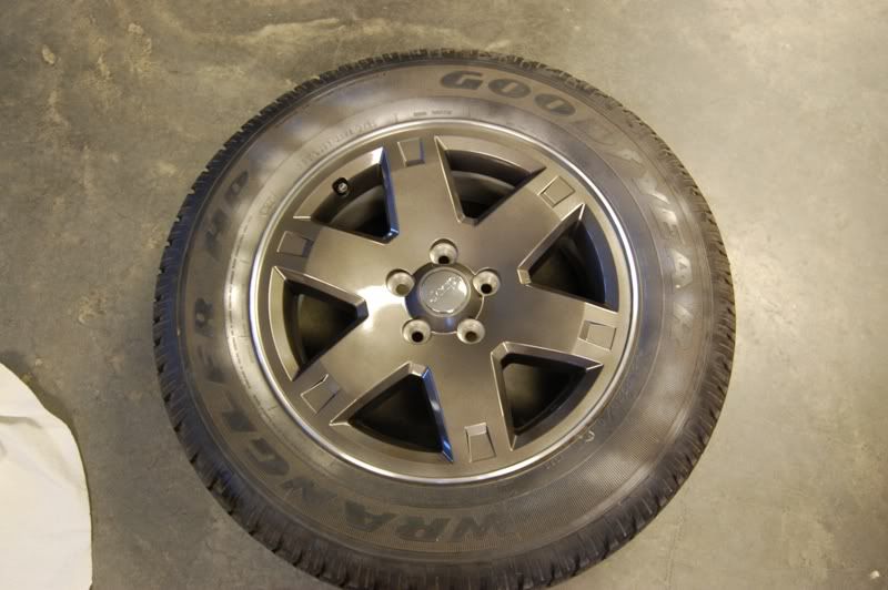

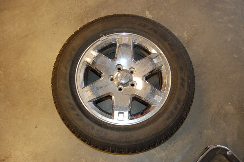

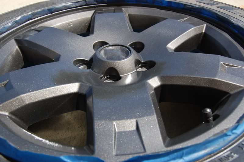

I started with these. They have been sitting around for a while, so they looked pretty rough.

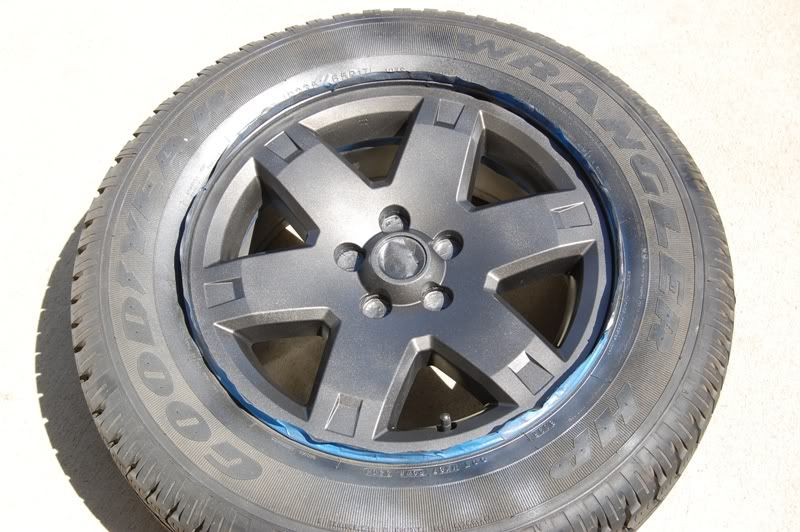

Taped up...

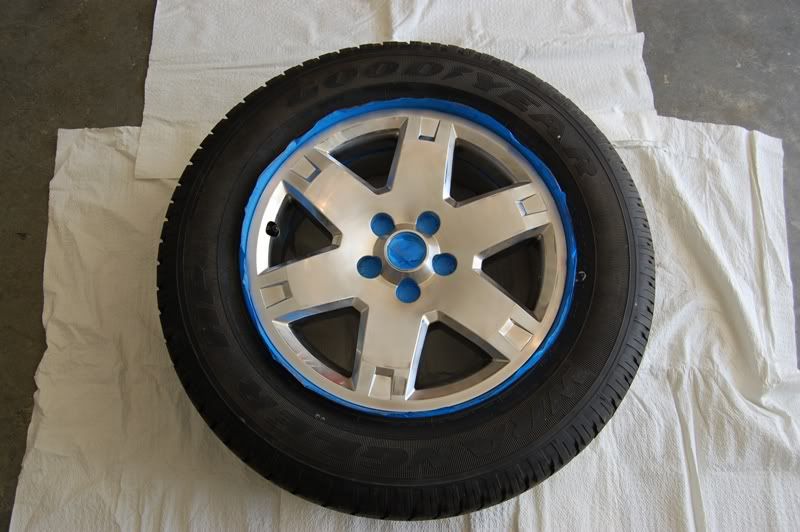

Sanded...
Color coat...

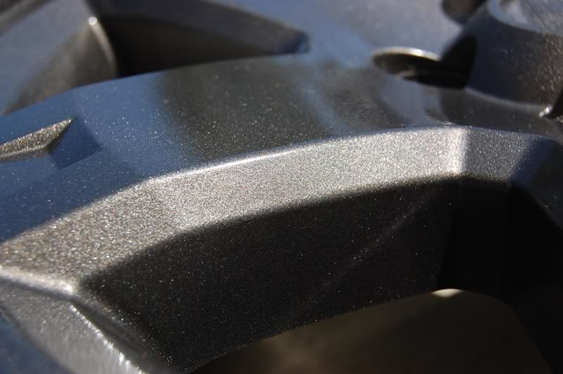

Cleared...

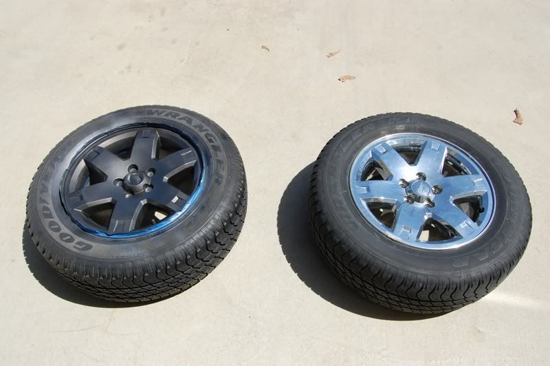

Before and after...
Finished...

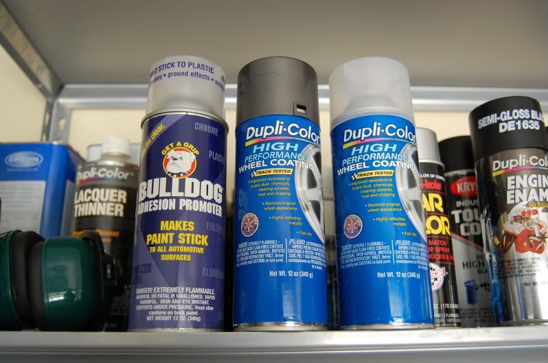

Products used...

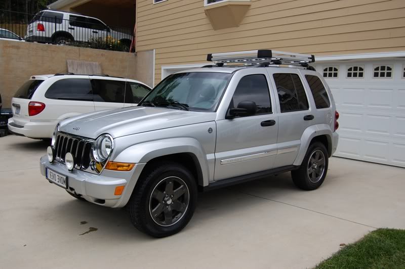

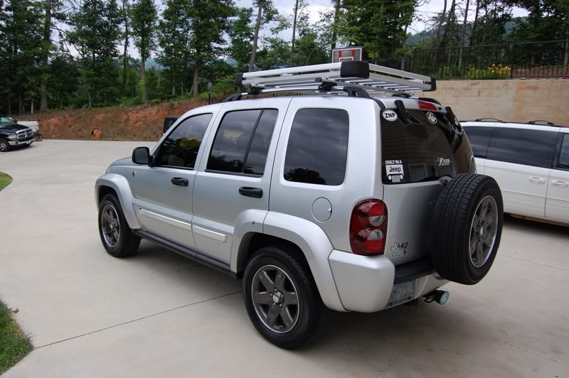

One the Jeep...

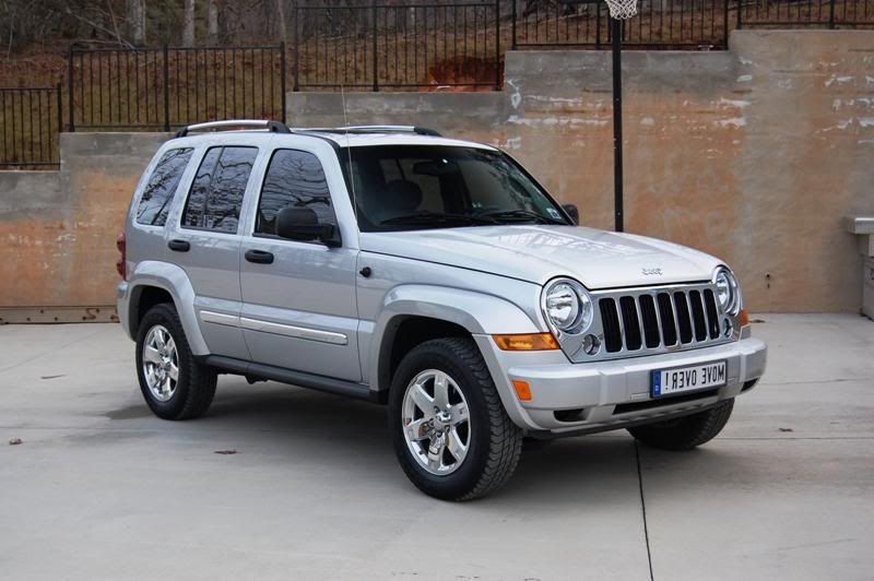

How they looked stock...

Thanks! Painting plated chrome and painting plastic chrome are two different animals. Plastic chrome is much easier to paint. I bet the tutorial was for plated chrome. It gets more in depth because it is much harder to prep correctly. I hate doing it.lol I've done it though, and it turned out quite good.

Tell more about that Bulldog product.Interresting.
Thanks!
It is one of the best adhesion promoters/primer I have ever used. You can get it in spray can form, or you can get it for a pneumatic paint gun. It sticks to just about everything and makes a great base for just about any paint. I've used it on several items that normally don't accept paint/primer, and it held right on there.
