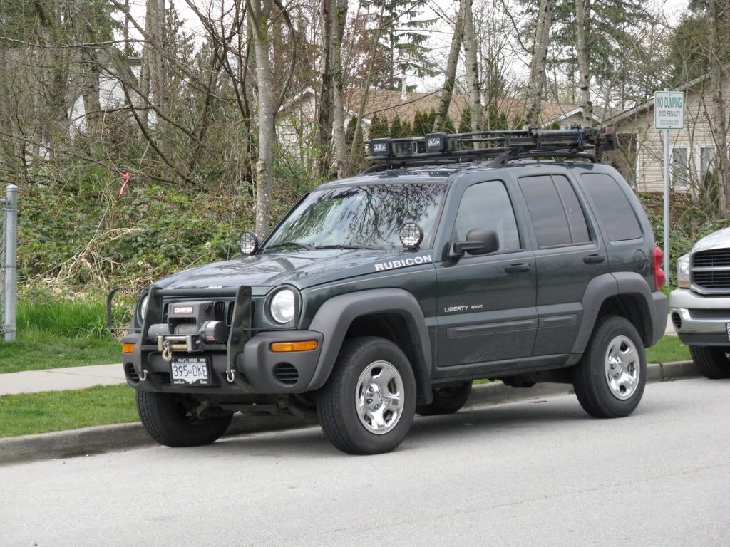

Alright i have driven by this guy about 4-5 times in the past several months, hes always going the opposite way though. BUT! Today, the jeep appeared 2 blocks away from my house outside of a park. So i snapped a few photos in hope that sum1 will recognize this jeep.
Location: Maple Ridge B.C Canada.
2004 Liberty Renegade
Silver, loaded
Full skid plates
Tow hooks
Flowmaster super 44

any idea how he mounted lights infront of the windshield like that?

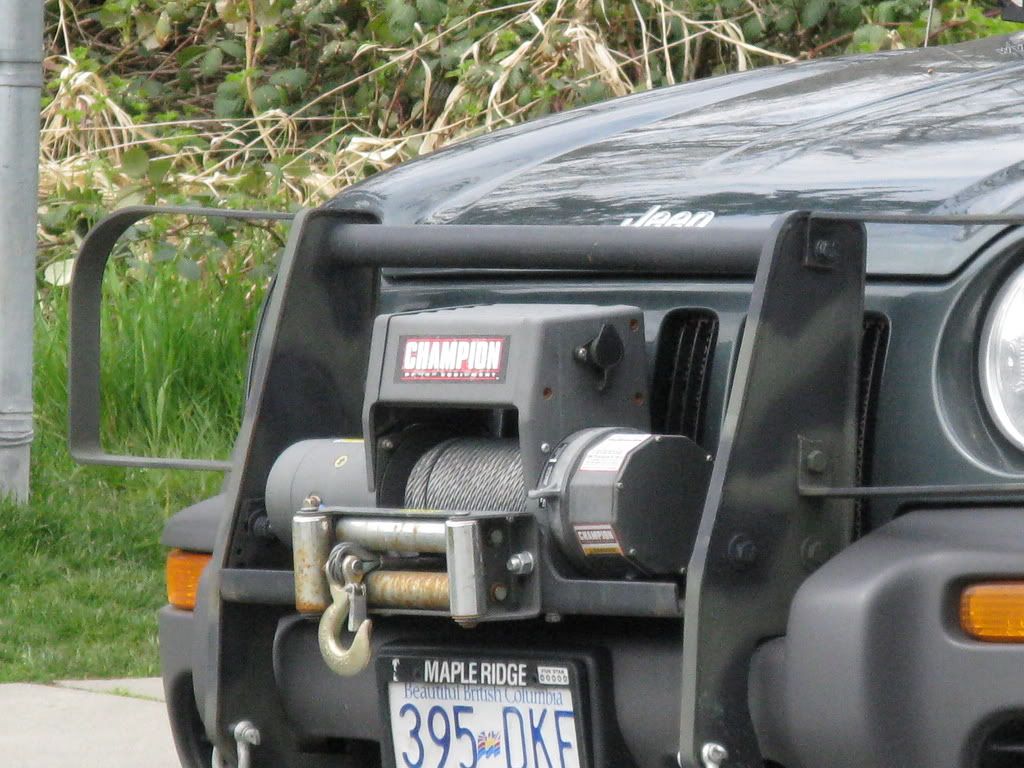

i wanna know what grill guard he got there for mountin that winch..

That winch setup looks down right scary,doesn't look safe at all and not strong enough to be useful for actually using the winch.

TJKJ it looks strong enough to pull a grocerie cart across the parking lot! :lol:

I would like to know how he opens the hood all the way with those lights there :?: :?
don't look like much room

Onto the light comment, there is another member around here that has his lights like that on his kj also so i am guessing there much be enough clearance because i didnt see any scratches or dents on the hood where the lights are lol
It doesn't look like it was even used. The rope is still in line.

Also i would not trust those shackles to anything but sitting there and looking tiny.

So, those of you more familiar with jacking/recovery, etc. sanity check me here:
- the gauge of the steel on the vertical members looks okay, but the fact that the winch is mounted on a section that's bolted on (not welded) and several inches away from the winch mount surface seems like it would put some stresses in some really bad places. Also ,the fact that there's no welded crossmember at the bumper-level would introduce a LOT of torsional stress if the user ever tugged from the side, probably more stress than the bolt points on the uniframe could withstand. Thoughts?

My opinion: It looks really sweet! As far as the functionality of it, like you all previously stated, its the same as mounting a huge racing spoiler on a 4 cyl Cavalier.

I used to work for the Indiana DNR and we had Ram 2500's with a very similar setup with their winches, just with out the head light protectors and the tiny shackles. Our winches were mounted on the horizontal piece that was bolted to the vertical pieces that mounted to the frame. Used them to pull out stuck vehicles and large debris. Never had a problem with them. Just my two cents.
