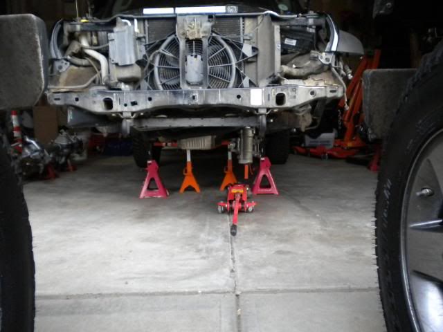

Hey everyone, so yesterday we cut out the upper mounts for the CO's, and i put the front and rear axle together finally. Next weekend we well be doing the welding for the LCO mounts on the axle. Also once the axle is sitting in the right place for the coilovers to work properly, we well check the steering. Right now we can some degrees to play with since we are using a JK box. Well update next saturday

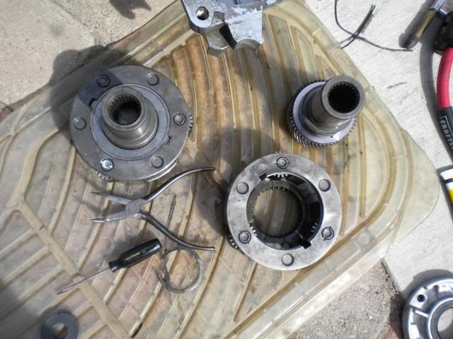

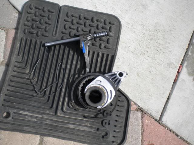

pulled the ABS and ESP fuses and bulbs already. Going to bypass. Got more work done today, well atleast rebuilt the t-case and tranny

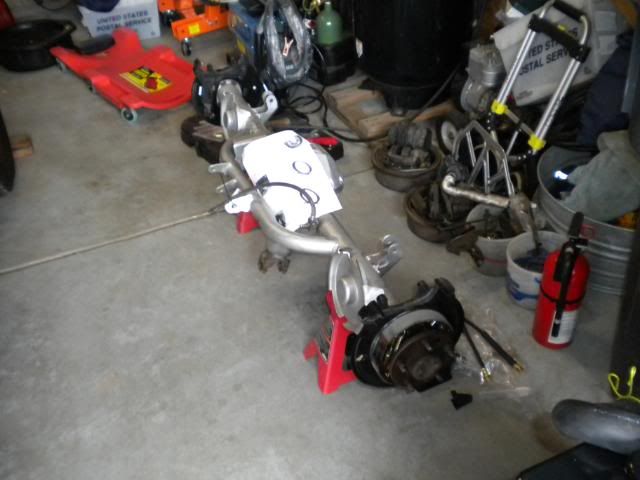

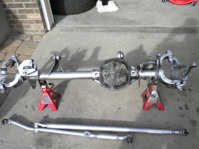

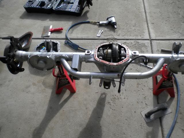

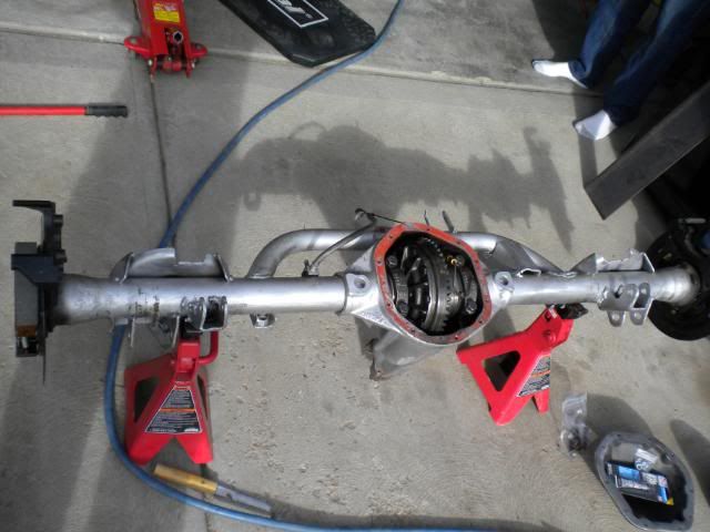

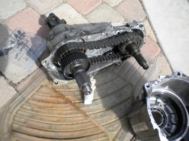

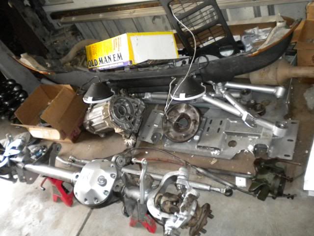

Promised pic's. Nothing far past this point. I rebuilt Both front and rear axle, and the T-case. T-case is now attached to the Tranny, and the rear axle is going in here shortly. the unibody metal is getting welded up here very very soon.
Here ya go.
D44 with 4.56's and ARB air locker, Riddle diff Cover, and disc brake upgrade
D30 Front with 4.56's open diff. PS upgraded steering. Riddle diff cover.
Pile lol-Its way cleaned up now.
And yes the Steering box is in and ya.,..

Went through cleaned it up and put a short input shaft in. Its all done now but the girl has the pics on her camera
