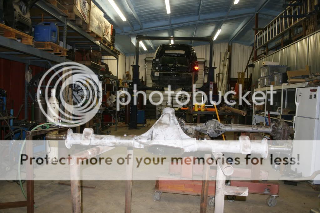

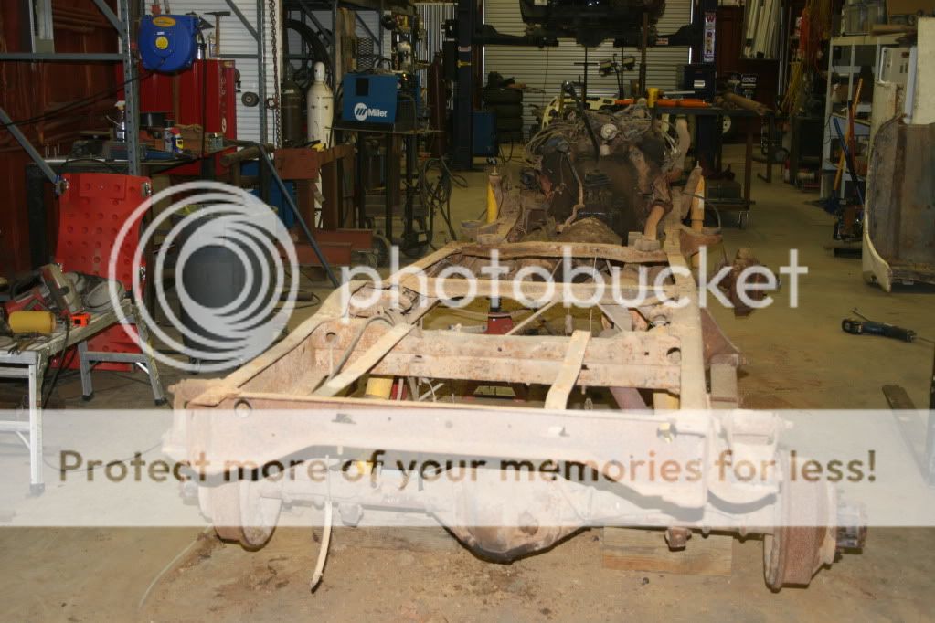

I tore down to the good stuff, dried mud, rust and grease. I have parted out most of the truck; motor tran and t/c, frame cab and title, are sold.
Sandblasting some rust and junk off, I love sandblasting, it is so refreshing.
Teardown of dana 60. My new cologne is gear 90.
Can anyone recommend a good supplier for ring and pinion and lockers?

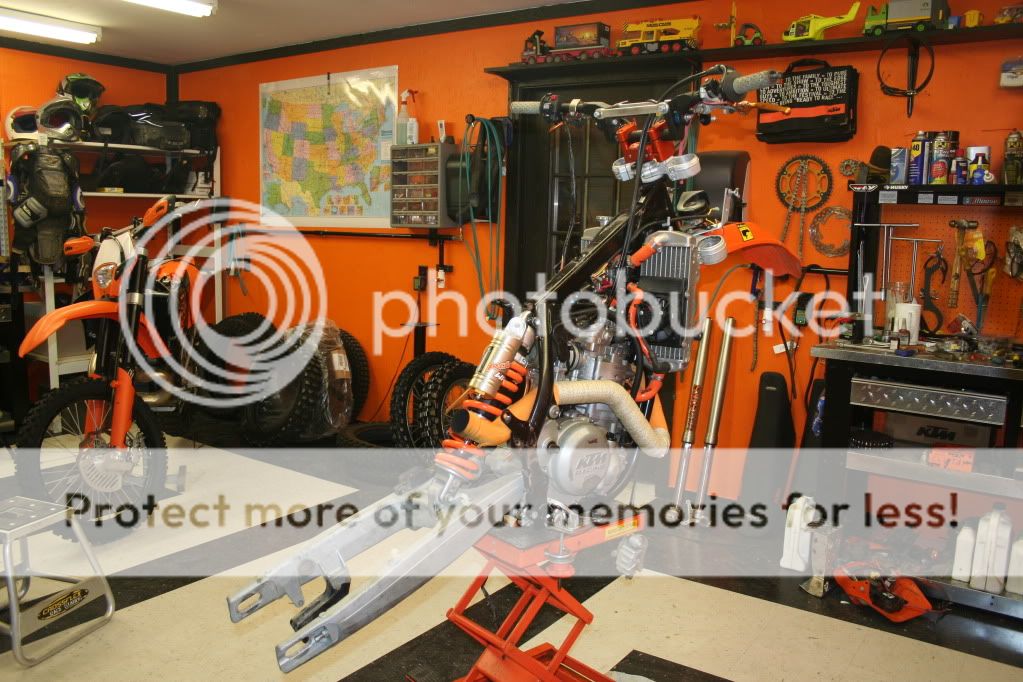

I have another project going that takes away from the CRD, I am planning on ridding my dirtbike on the Trans Am Trail western half in late Aygust and September.
The KTM 525 is in pieces as well with the motor torn down for rebuild.

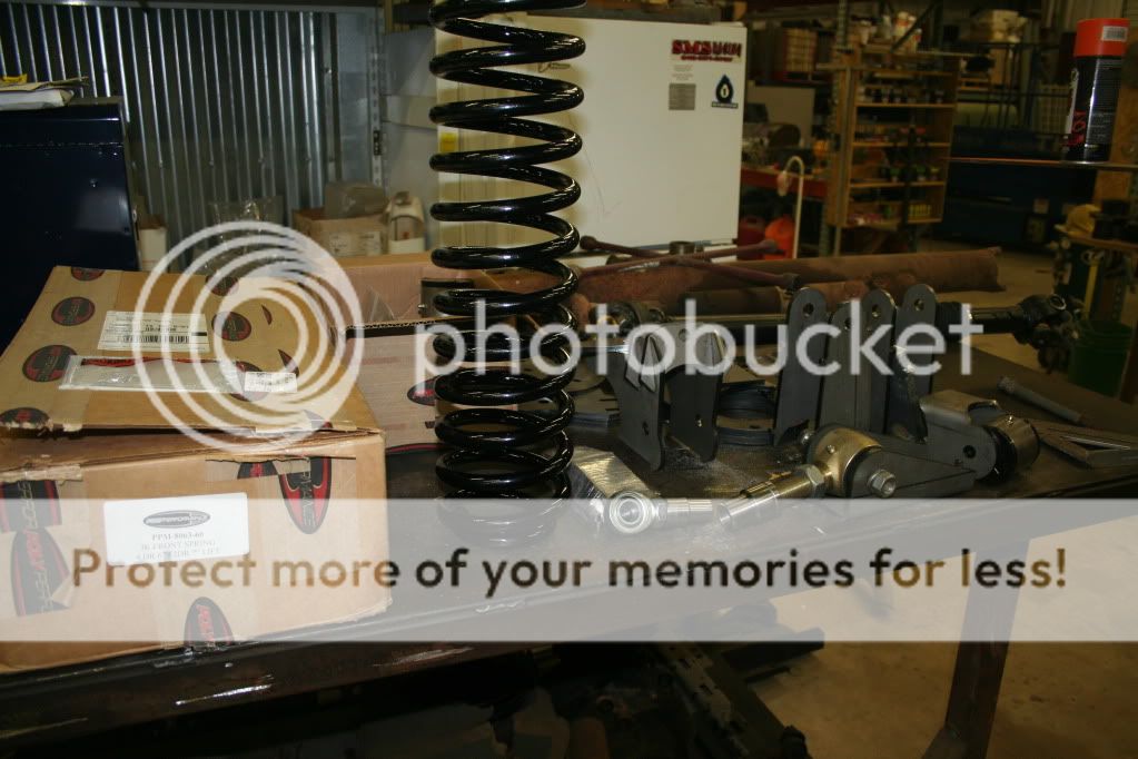

I didn't want to wait for a axle nut socket to come, in so I made one, Not pretty but it worked better than a screwdriver.
My sixteen year old son busting the ball joints loose, lol, I turned him loose with the ball joint press. No instructions, he had it figured out in a couple of minutes. He started out with the 1/2" impact and ended up using the 3/4" socket.
242J Transfer case apart, waiting on machined parts.
Beefing up for suspension.
Waiting on joint ends etc. to come in, anxious to start the link suspension.

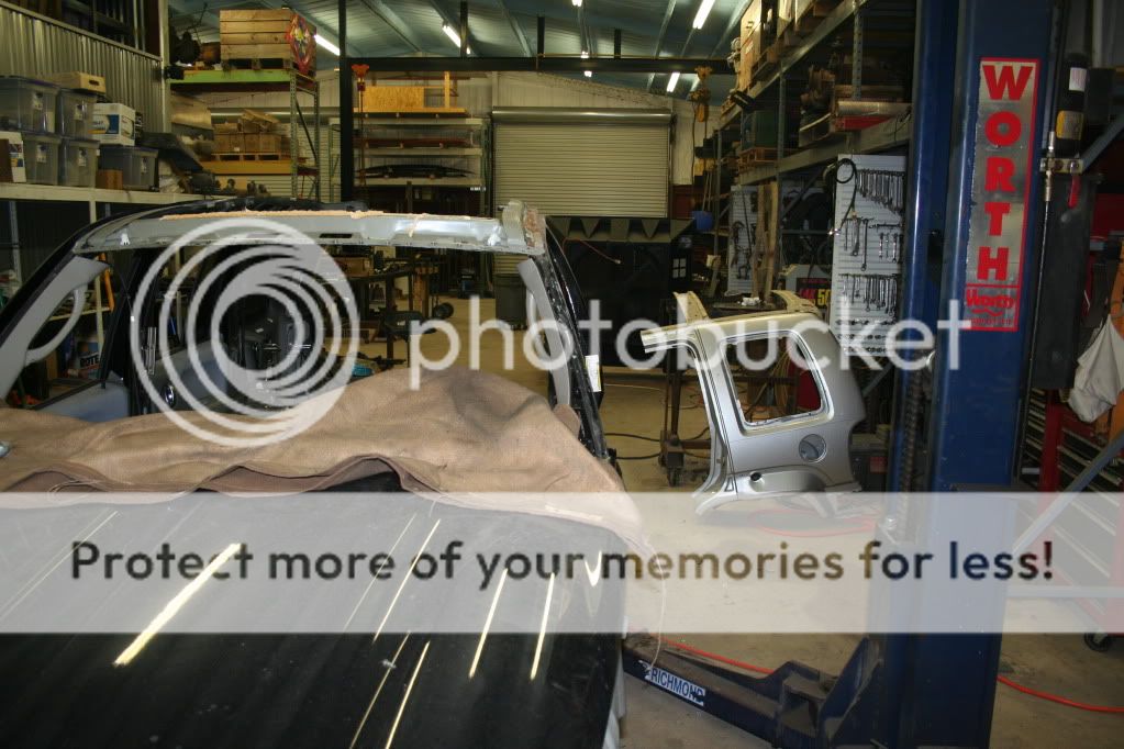

I have been doing some body work on the CRD, I found a wrecked 2003 with front end damage. I bought the roof and rear quarter panel along with two doors. Brought all this home and started drilling spot welds.

I cut out the rear quarter panel,
I tried to cut the donor as close with a little over lap as I could. This is fun stuff.
Ive been accumulating suspension parts along the way, I have the DOM tubing for the link susp. I thought it might be easier to do the body work rite now while the suspension is off the Jeep. Shorter working surface. LOL
The other spare time I've been reassembling my bike for the September trip to Nevada, Utah, Colorado, New Mexico. Next summer I want to do this same trip in the CRD SFA.

Last night I started putting boby parts back on the CRD.
Installing the rear Quarter panel requires a lot of patience, removing, trimming, installing, removing, bending, hammering, trimming, installing. It is in now, welded in place.
The roof panel is just laying there, I need to locate some adhesive to glue it in place and the spot weld.
