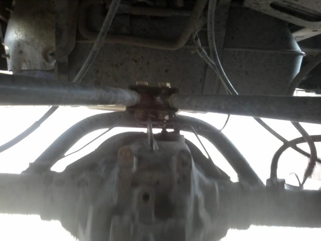

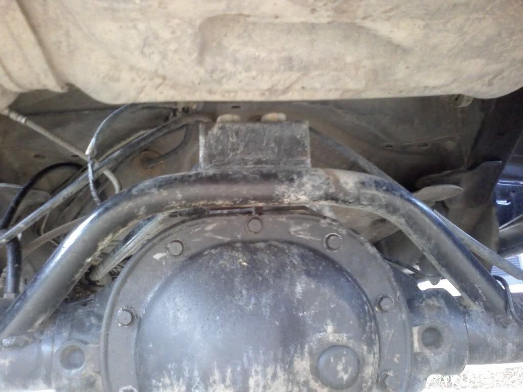

the only thing i had was a camera phone...so sorry about the quality, i describe what your looking at...
the first two pics is the rear and front of the rear axle...this is the truss that was made for the upper arms...

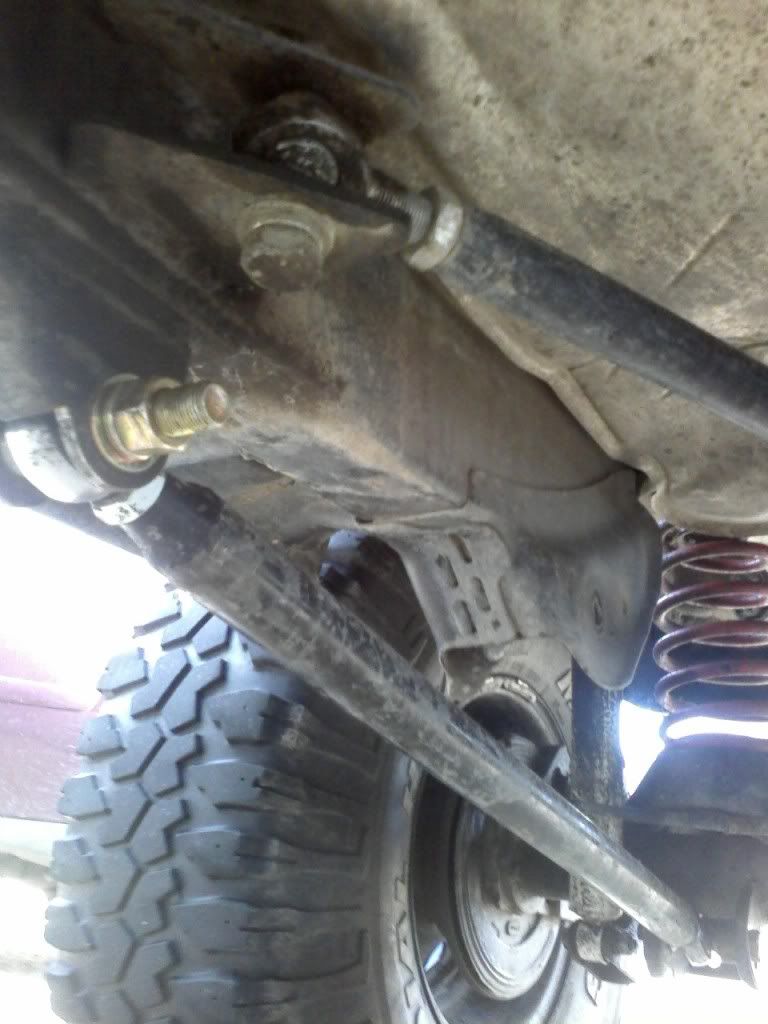

next is the rear arms that connect to the body 3/16th metal was used i think

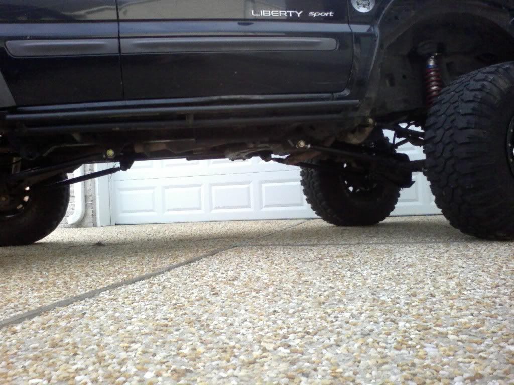

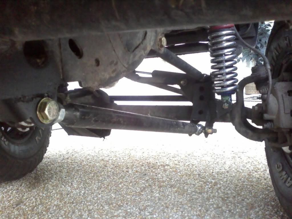

now the new front arms
you can see how far the arms come to the center of the jeep now

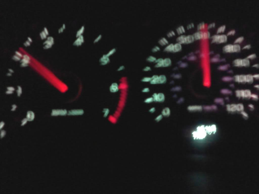

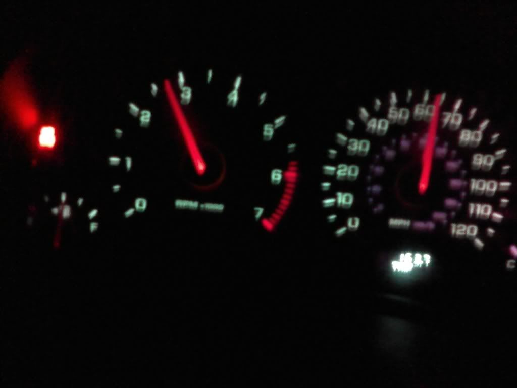

this is a pic of where the RPMs sit before over drive and after...the speedo is off by 5ish...I'm doing 70ishMPH

So are you doing all this extra work yourself or is it a shop? Are the long arms custom?
My Jeep Build ----> Big Black
PostPosted: Sun Dec 14, 2008 5:17 pm
Posts: 991
Location: Flanders, NJ
this is a shop and yes the arms are custom

You should get the old control arm mounts cut off the back. Cutting off the old mounts was part of the instructions for the installation of my long arm on my LJ. When the new long arm swings up during compression, it will hit the old mount and stop you from getting maximum up travel.

well at full flex my rear arms don't touch it...i will notch out the center just in case...the arms are made of 7/17 inch wall DOM...i don't think they would be bending... 8)

really as long as they are adjustable...the arms should only matter in strength... never buy solid arms...you want to have that adjustability...i'm going to make a new thread for long arms so mine doesn't get clogged
