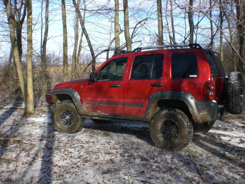

I currently run 31x10.5x15 Interco Trxus MTs M+S and they are AMAZING!
Wheeled with them at LOST ECS 2011 a few weeks ago and they performed really well. The tires were aired down to around 20 psi. Would have went just a tad bit lower, but stuck at 20. They ride alright on the road for a MT. Mind you, this is an off-road tire, not a daily driver/street tire. There is a noticeable wobble when driving. That is due to the tires. When I first drove with them on the KJ, it felt like the KJ was drifting from side to side. Again, this is due to it being an MT. I've put some where around 2,500 miles on them and bought them used with around 3,000 miles on them. They're currently mounted on 15"x7" 5x4.5" bolt-pattern Black Cragar steel wheels with 4" of backspacing. MPGs are about the same as when I ran 245/75/16 BFG KM2s (MT) on stock Renegade wheels 16"x7". When it has rained, they did not slip. The sipping in the tread is designed to open up when it hits moisture, meaning better gripping in rain and snow.
There's PLENTY of tread left on these tires and I cannot wait to test them out this winter. The only draw back to these tires is two will balance perfectly and the other two will not. So if you ever buy these tires, figure out which two balance and which two that do not. Put the good ones up front and the bad ones in the back. That is what I'm doing and will leave it as is until they're bald. I like these tires so much, I'm considering buying a new set when I need tires next year.
Just thought I'd share something with my fellow LOST Jeepers. If you're looking for a MT tire that will perform well out on the trails, I suggest the Trxus MT.
NOTE: You're MPGs will drop significantly with an MT tire. I currently get 15-17mpg and less if I constantly drive in town all day.
