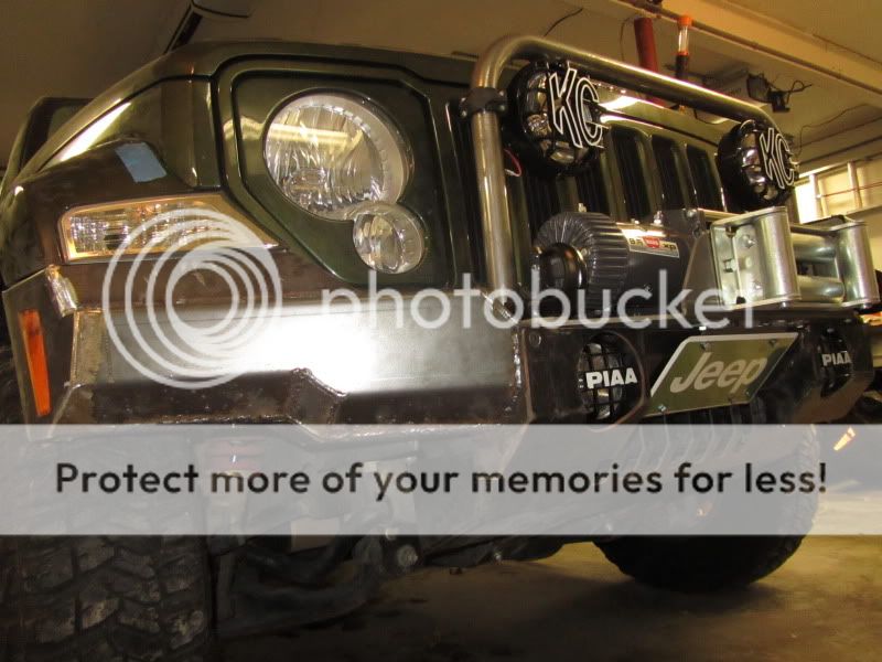

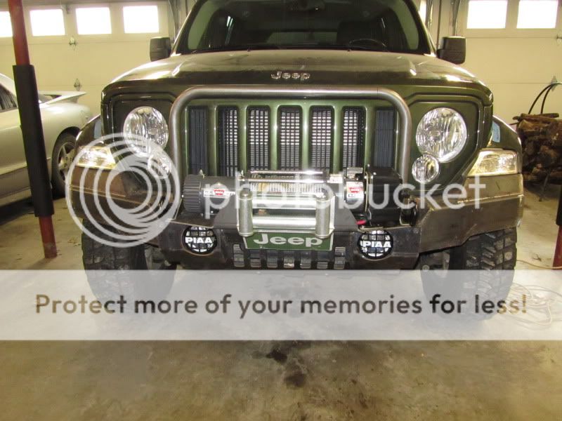

Ok, now for a little update from this past weekend. Since the welder tech at the street rod fabrication shop I'm (now) working with was going on vacation this week, I repossessed the KK last Friday to bring it home for some review, testing, mock-ups and design fine-tuning. The front bumper in these photos is actually the second one fully made from 100% pre-made parts. Although full-welded, none of the welds have been dressed as they obviously will in my final prototypes as well as in the final products made for me by other fab shops in batches.
Although not the actual hi-lift jack point, I did a little testing by lifting up the front corner of my KK with my hi-lift jack at the very outside end of the front bumper.
Then, I decided to (yet again :dizzy: ), bolt everything in place, including some recently made parts. This included assessing options for front license plate mounting. Front license plates aren't required in Kansas where I live, but I know they are in many other states and sometimes people want a front license plate of some sort even when not an offical and required one. So, an off-the-shelf option would be to use one of the license plate brackets like the below that clips to a roller fairlead:
But if you didn't want such a flat brick-face wall at the front of your KK, I designed my front bumper to accomodate mounting a license plate aerodynamically and aesthetically integrated, while not impacting approach angles:
You'll see more of it in my next post on my basic Grille Guard Hoop .........

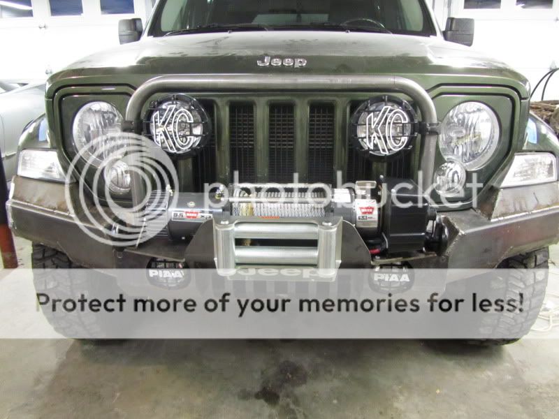

As you should know if you've been following my thread, I've designed my KK off-road front winch bumper to be either as-is or to accomodate 3 different bolt-on front end protection options (basic Grille Guard Hoop, full-width Brush Guard and forward-leaning Stinger Hoop). Last week I picked up the couple formed tubing options I had formed for my basic Grille Guard Hoop option and then test fit and selected the below:
Accessing and opening the KK's hood is no problem. The only problem is that with the Grille Guard Hoop there, you keep wanting to grab it when leaning into or out of or down below the Jeep. This won't be an issue in the final product when the hoop is welded to its mounted brackets (that are each secured by 3 bolts), but for me this past weekend, it created some amusing moments for my dad and I as one of us would repeatedly pull or lean on the hoop and since it was only sitting there, it would give way. :ROTFL:

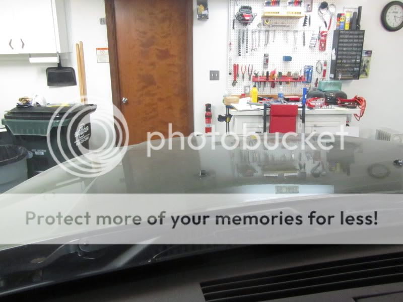

I wanted to insure the basic Grille Guard Hoop didn't interfere with the driver's line of sight when wheeling:
Really, it's all there in front of the grille, you just can't see any of it from the KK's driver's seat (although you can see how cluttered my garage workbench gets when working on my Jeep :lol: ).
Besides looking cool and offering additional protection for the front-end of your Jeep, what's a Grille Guard without the option to add additional off-road lights? So, I took my PIAA round-tube mounting brackets (I had from when they used to be mounted up on my OEM tube bar) and played around with visual spacing with a couple 6" 130W long-range KC HiLites (121)....

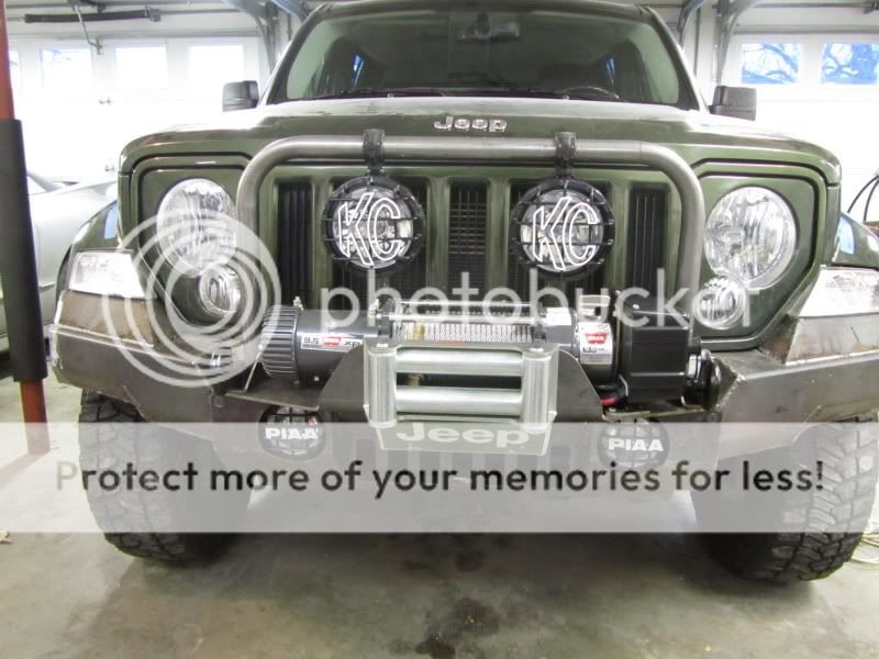

Mounted off the horizontal of the Grille Guard Hoop:
I've seen a lot of Jeeps with off-road lights mounted here even though it blocks some radiator exposure.
So, I played around with mounting them up in the "corners" of the Grille Guard Hoop off the sides of the hoop:
After playing around, I think I'll put light tabs on the sides to match the above and a couple on the horizontal top. When lights are mounted on the horiztonal, the tabs on the side can be used to secure the wire loom going to the lights.
I was pleased with how this worked out. I'm waiting on some feedback from my tubing bender guy before I finalize layout of the additions to the basic Grille Guard Hoop to turn it into a full-width Brush Guard to extend out and protect the front headlights. I'm also needing some input from him as I laid out a couple options for the Stinger Hoop. One would be much easier to implement but is more complex of a tubing bend while the other is easier tubing bends but more complex of a weldment and would require more pieces and be more expensive. I'm hoping in a couple weeks to post something showing test-fit of Stinger Hoop.
