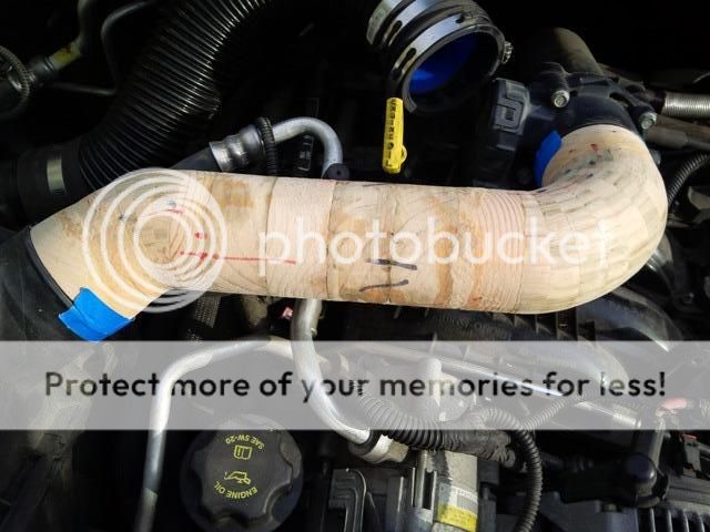

I gave up trying to find an intake tube so now I am making my own.
It will be fiberglass. Here is a final test fit of the mold. It took 21 pieces in total to make.
3-1/8" on the TB side and flared to 3-3/8" for the stock air box.
It is pretty darn close, so now I added one more piece to each end for a little play with the glass. The extra I will cut off for installation.
I've rounded off the corners and did most of the filling of holes. Next is to build it up with sandable "building" primer. Then take it back down to 3-1/8", paint it up and the mold will be complete.

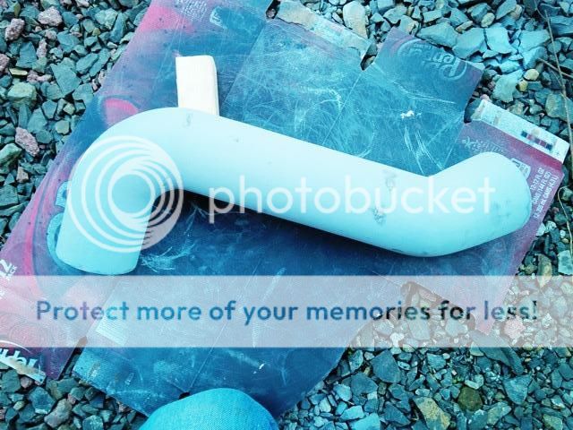

I have made some progress on my intake tube mold.
Second coat of primer, sanded down. Now it is looking pretty good.
Sprayed a third coat on it and it is now sitting to allow it to get well cured before the final sanding. Then I will be painting it. Once that is done I can make the fiberglass tube.
I'm not planning on selling any of these. Going to make a couple for me to have, one for the rig and one backup.
At that point, depending on how well they come out, I may get rid of the mold.
I too am still seeing better mileage then before. Not much but every little bit helps.
