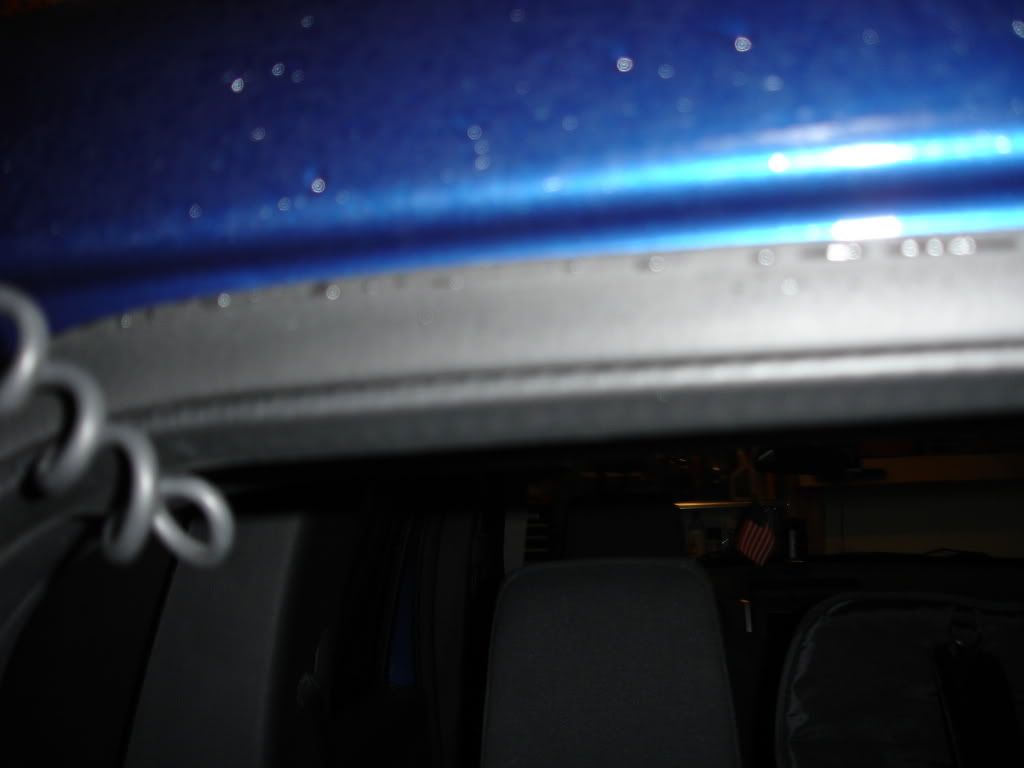

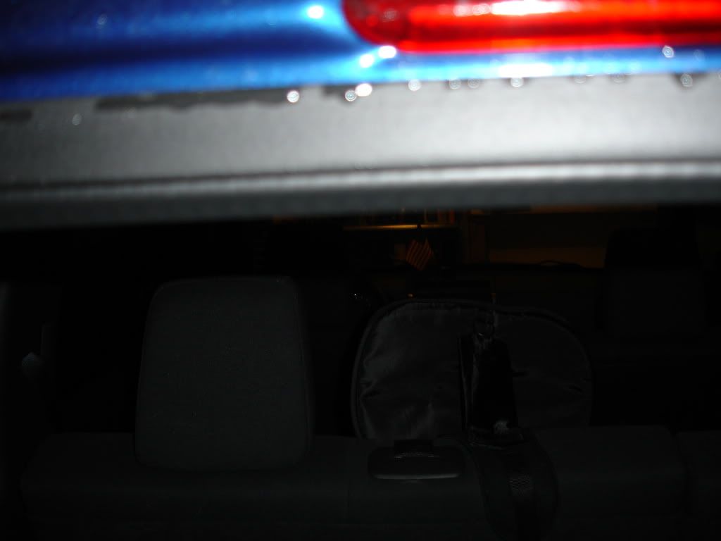

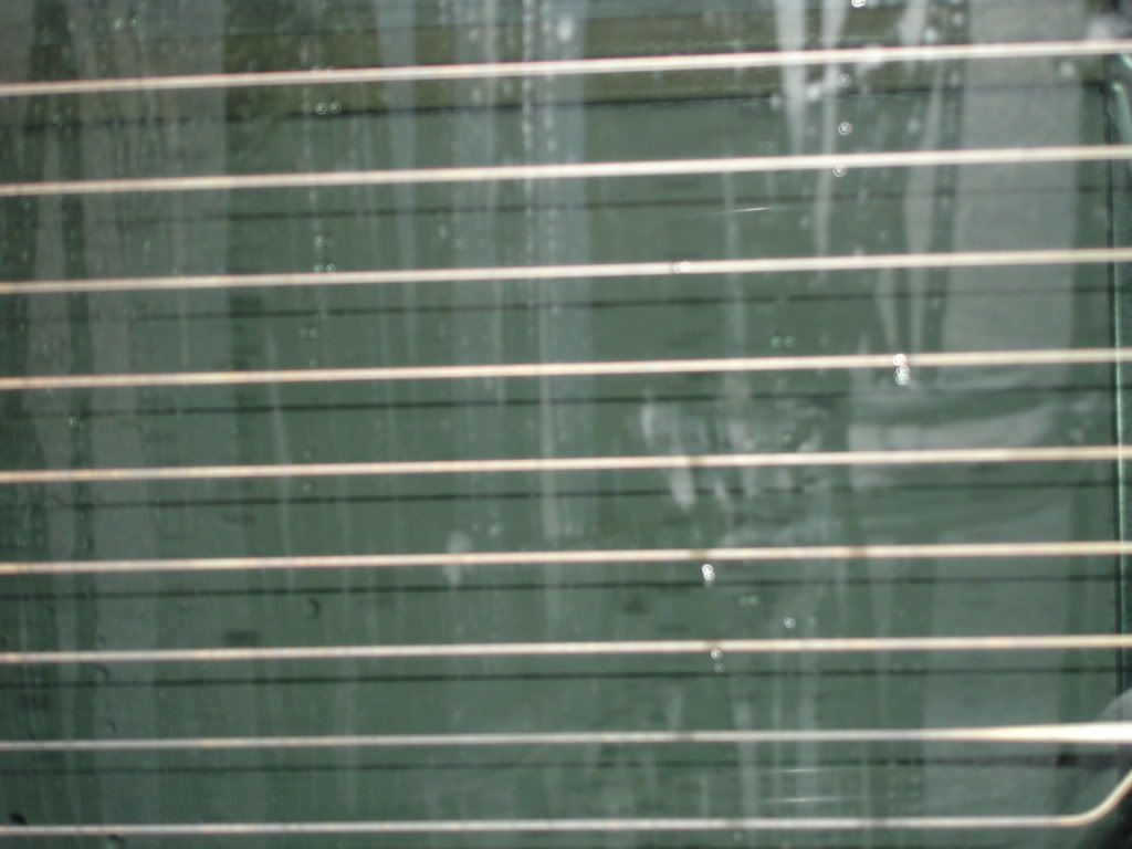

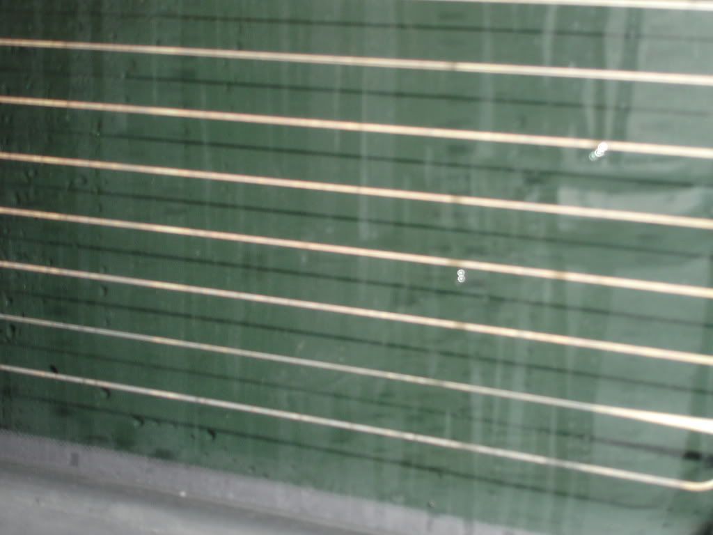

Ok so heavy rain has moved through the Chicago area tonight and the wife was at work for part of it and then drove home. When she got home tried to take some pictures and granted not sure if anyone will be able to see this or not but it is leaking BAD, the streaks in the picture that if you look closely you can see are all areas where water has run down the inside of the glass on the rear window.
What the hell do we do now, the dealership that we have been going to orders a new seal and then never calls us to tell us it is in, we schedule an appointment, which means absolutly nothing to get the new seal installed and it takes them hours to get it done, or the Jeep sits for hours before even bringing it into the shop. They "test" it using a garden hose or the car wash which the rear window never shows signs of leaking, I've even tried it at home myself, but when it rains we get doo doo like this that happens.
Don't have to be driving for the window to leak, just being parked outside if it rains hard enough and the streaks will be down the glass.
Tonight my wife said while driving home it wasn't just drips going down the glass an actuall "stream" was down the glass.
The dealership has replaced the seal 4? times I think (need to pull receipts) and adjusted the glass and it still gets no better :banghead: :banghead: :banghead: :banghead:
Ok the pictures, like I said if you look closely you can see where the water has run down the glass, this is all on the inside however you will see some drops on the outside of the glass.
