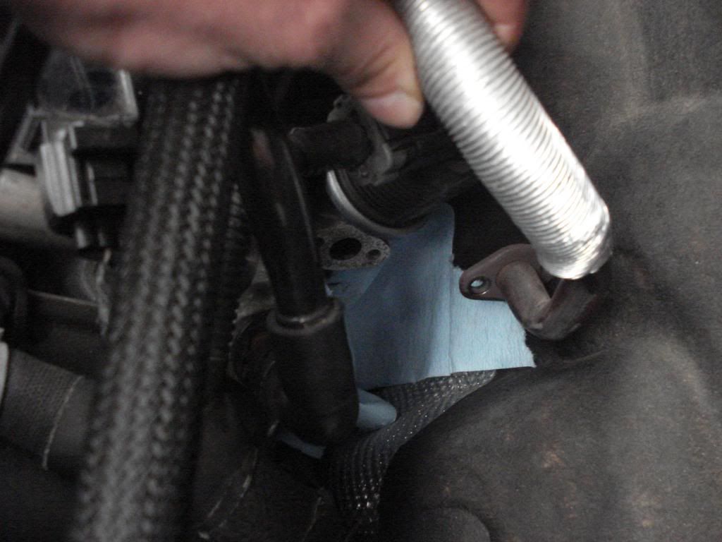

Hey guys. I too am having similar problems and want to change/clean both my pcv valve and EGR valve....does anyone have a photo showing where they are located? I can't find this anywhere, was hoping you could help?

Both EGR valve and PCV are located on the drivers side, against (very close) to the firewall. The EGR valve is close to the outboard side of the engine compartment and the PVC is inboard of that on the intake. Sorry no pics from me, but there is a picture of the EGR on the first page of this post. PCV valve is super easy, haven't gotten to the EGR valve yet, but also very easy looking.

Here's another picture for reference.Image
