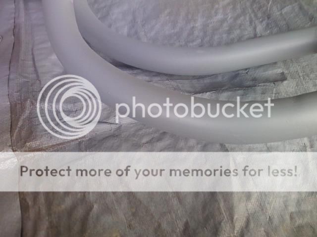

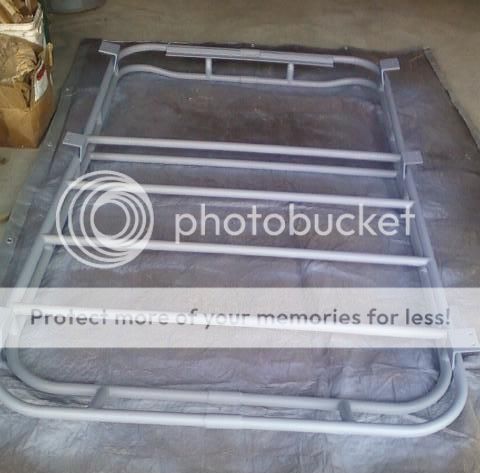

I have the first coat of primer on the bottom of the rack. It turned out well, but took forever to cure because of the cold. It is also very odorous and stunk up the whole house, even with the garage man-door closed. I had the garage roll-up door partially open for 2 days trying to get the garage vented. This was 4 days ago and it still stinks a little.
Anyway, here are the progress Pics as promised.
I used almost 1 complete can on the bottom.
Now to flip it over and do the top side.

I did the top side today. My garage is not heated so I heat it up with a Kerosene heater to about 65-70 then I turn off the heater and wait for the heater to cool off. Then I hit the rack with the primer. Let cure for about 30-45 minutes and open the roll-up door partially. Place a fan at the opposite side and blow in fresh air. The smell goes out the top and other side of the door.
Ideally I would wait till summer to do this outdoors, but I just couldn't wait. :roll:

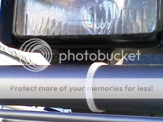

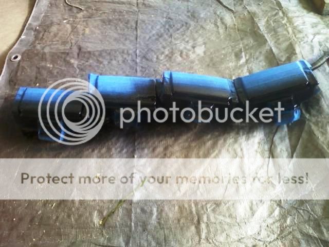

Since the rack was painted, and the lights were off of it, I figured it was a good time to do a little Plasti-Dip on the bottom edge of the lights. You see, when I had the lights "On" the bottom edge of the lens would allow light to glare too close to the rig. So by adding a little Plasti-Dip along the bottom edge it creates a cut-off line and shines the light out in the field without the glare I had before. So I taped them off and sprayed away...
Because the Plasti-Dip does not stick well to glass, I used a razor to cut along the tape to prevent it from pealing off. Now they look like this.
When I took the rack off, I left the flat bars on. I forgot to take the nuts and washers off the roof when I did this. Believe it or not, they were still all in the rails when I went to reinstall the rack today. I got lucky there.

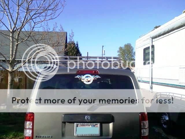

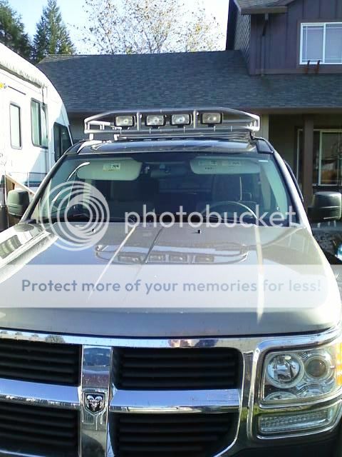

And finally here is the reveal of the New Stainless painted rack.... Drum roll please!
The rig looks the way it should again.
Hopefully, with all the Prep I did this time around the paint will last more then a year, and actually stick to the Galvi pipes.
