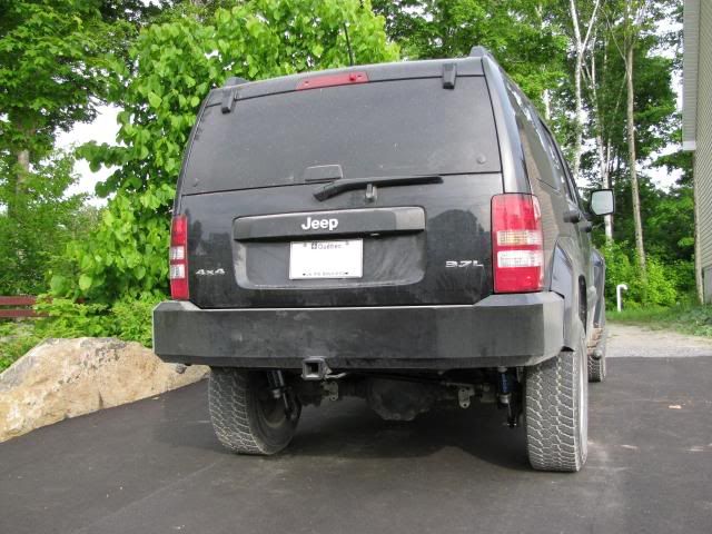

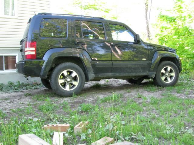

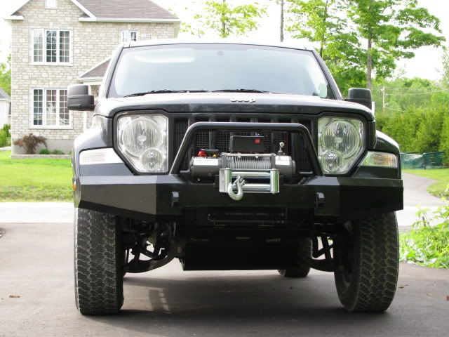

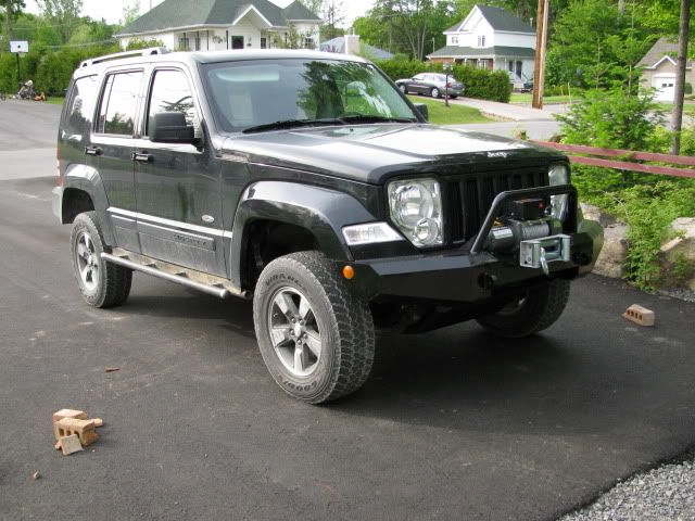

how does this lift compare to what digger has. Looks so much higher!!
we both have the same rear springs but I have 1/2 spacer on top of mine. in front on the pics of digger's jeep you can see that the front is lower than the rear and on mine both ends are at the same height so I can say that my lift is a little more than a complete jba4 kit but I guess digger will pull some more tricks to lift his kk even more :twisted:

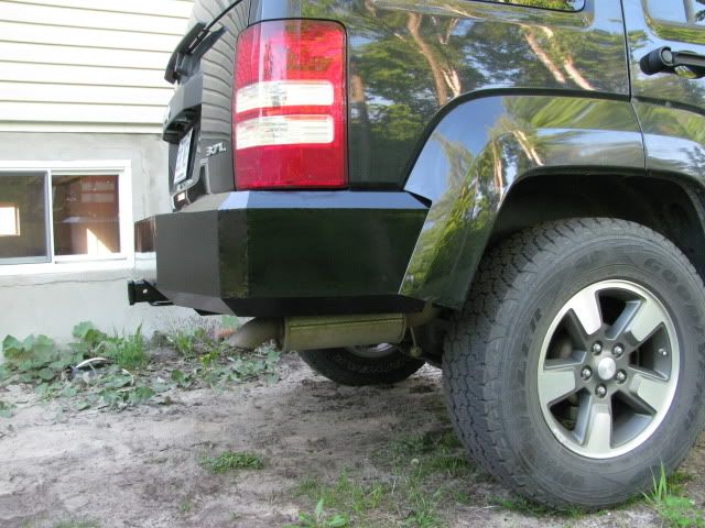

WOW! Great job Bob.... Great job indeed - but... what's with the rear bumper? Is it the same bumper in both pics? If that is your rear steel bumper... that looks 100% stock!
yes on both pics its my steel bumper see the pics below
Now when are those 33s coming?
tires and spacers are ordered. they should be on in 2 weeks

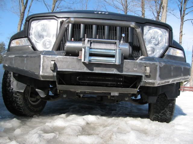

Got some more shots around the truck front back????
yup
stock front
stock rear
you can see the resonator hagning way too low
08 KK north, select track
12k titan winch
3'' fox lift, Jba A arms

How does it ride? It looks great! You really have a unique KK

the ride is pretty stiff but still comfortable. I have a lot more control when I hit bumps. over all better but the shocks need tuning then they should be awsome :D

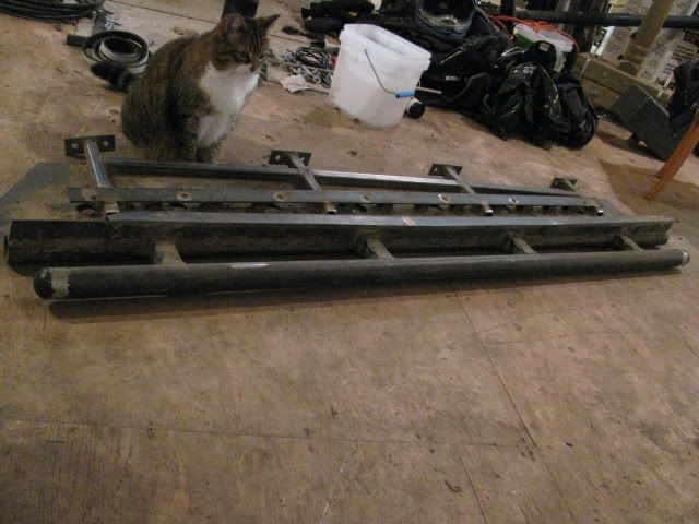

I need some info on your sliders...
theres not much to say about them other than they are heavy
I think I could put a bomb under my jeep and not even scratch it :lol:

Boblemoche wrote:
What do you think they weigh? How exactly do they mount? I see 4 mount arms and then that flat bar strip with 7 holes in it. What does the flat bar mount to? Are they telescoping? What is the big mother triangular piece and how does it mount to your jeep?
I'm not a cat person, but that cat that keeps popping up in your pics makes me crack up.

they weight close to 100# each. theres nothing telescopic. I drilled holes in the frame for the mounts arm. the triangular piece is a 3/16 plate with holes lined up with the drilled bar to insert a rachet. the drilled bar makes contact under the doors starting at the pinch weld. I used rivets similar to the tranny skid plate rivets in the holes in the frame and under the doors where it looks like a long pinch weld lol I dont remember the name.
oh and my cat always check my designs and must approve before I can install :lol:

If you ever get a chance, I'd like to see better pics of them mounted to your jeep. :D

I removed them yesterday to paint them . Ill snap a few shot when they get back
