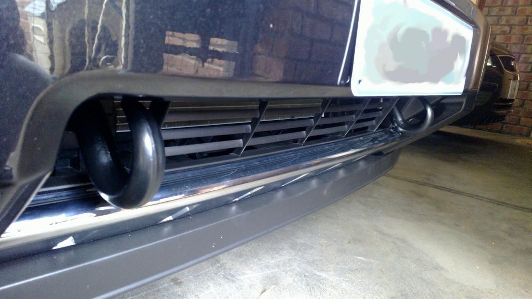

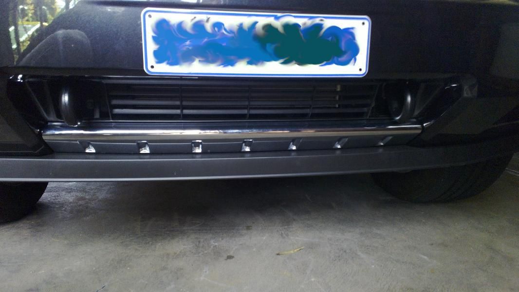

 Post subject: Re: Installed dual KJ tow hooks on the KK. Pic's inside!
PostPosted: Tue Jul 31, 2012 5:39 am
Joined: Wed Jun 20, 2012 7:05 am
Posts: 28
Location: Australia
Have joined the KJ hooks on a KK club :)
Bought these from Chrysler Winona Parts 4 weeks ago but the weather has been so lousy here in Adelaide I haven't had a chance to do anything to the car.
Anyway, was a pretty straight forward job to install them, and happy with the results.
