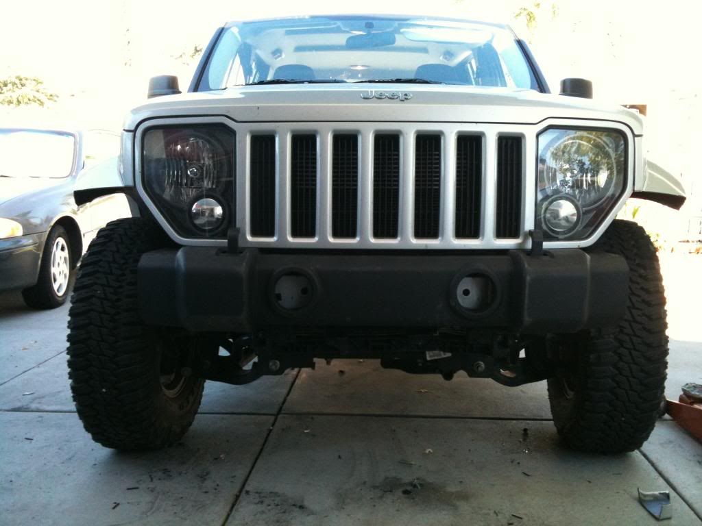

https://imagizer.imageshack.us/v2/240x3 ... 4/ezyc.jpg
I keep the entire bumper and cut the fender flares. I also cut out the blinker brackets and bolted them back on, it did require me to drill a hole in the fender flare to keep the blinker from bouncing around. As far as mounting the bumper, I drilled holes in the frames cross member and bolted it right on. It fits on really tight, there are a few things that need to be cut away to get a tight fit. The JK metal bumper fits right over the cross member, with a strong kick. The two inside bolts on each side of the JK bumper are difficult to get the nut on, you will need to cut a area just big enough to get it on and wrench it down.
I do plan on putting on different blinkers and make the bumper a stubby.
2010 Liberty
245/75/16 Goodyear Duratracs
JK front bumper

if you are using a full size bumper there is no need to cut.
PostPosted: Thu Mar 20, 2014 11:35 am
Joined: Sun Jan 19, 2014 10:52 pm
Posts: 59
Location: Yukon, OK
Not sure what you are saying doesn't need to be cut, but the fender flares must be cut for the fullsize factory JK bumper to fit.
