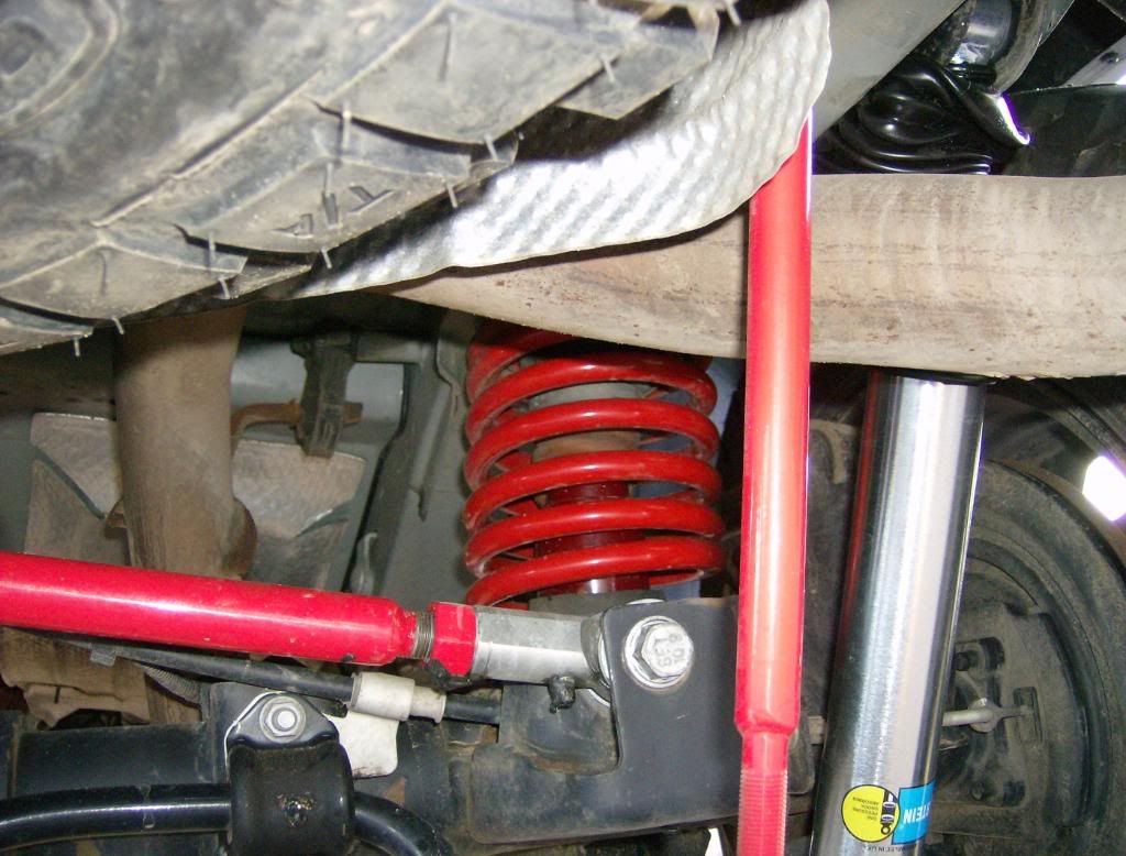

Here...I borrowed Digger's picture....
Basically you will see the yellow bumpstop inside of the rear spring....get underneath the vehicle so you can reach it, and follow that up with your hand. You'll come to a black metal plate/round piece that surrounds the yellow bumpstop. The upper outside edge of that metal piece was coming in contact with the inner edge of one the upper rungs on my rear driver side spring. When the wheel was off I could see the scratching it caused on the plate/piece and on the spring. Just now, I was able to feel the scratches with my hand...though I can't locate them on the spring since it has been rotated and I am too lazy to follow the whole spring searching for the problem.
If anyone starts hearing a chattering noise, I suggest opening the passenger door, gripping the roof and rocking the vehicle. This is what Marlin and his associate did to recreate the noise, and they were able to diagnose the problem.

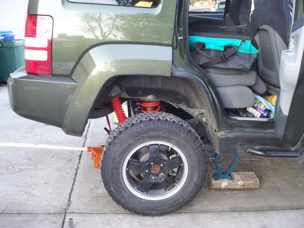

this is the only other picture I have.. still not much better

Actually, that picture is perfect! If your eyes are good enough to read this post, you'll be able to see the lip on that black piece in Digger's most recent pic. That is the part that was getting chewed up.

PostPosted: Thu Apr 16, 2009 10:13 pm
got ya, so it was the black rubber spring isolator right?
It was the top part that is made of metal.
Hey...thanks for having me here. - unclejjg
PostPosted: Thu Apr 16, 2009 10:28 pm
Oh so the upper spring seat. Got it now

Here is a better Pic of what you are talking about.
Was it the outer or inner part of the spring that was hitting?

Digger: yes, if that is the name for the black metal piece.
Scar0: It was the side closest to the tire (so outer), but it was the inside of the spring that was making contact (it would be nearly impossible for the outside to make contact on something housed inside of the spring).

Thanks unclejjg.
The inside of the spring was rubbing. Got it. Good to know and I will keep my eyes and ears open.
