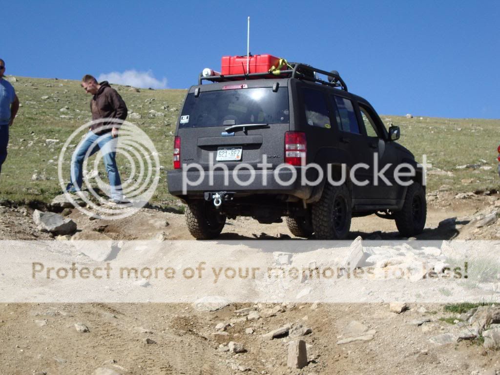

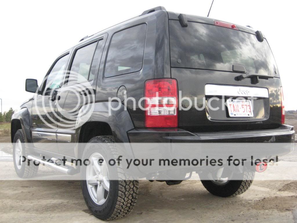

Digger, I didn't want to ask you directly because I wanted the answer to be public. I have seen people that add hitch to kk and add it below the bumper. I know that yours is not below the bumper. you have the little bumper cutout out and the hitch sits high for a better departure angle. Do you have the stock mopar hitch or another. I dont want to be adding stuff that will reduce my clearance.
Yours...Image
also good...Image

Looks like the same hitch I have which is the Mopar one ... I don't see anything different.

Agreed - I also have the Mopar hitch, install was a peice of cake - and it tucks up into the bumper a bit too.
You'll have to cut a strip out of the bumper (it's actually already indented - look at your bumper - you'll see it). Easiest tool I found to cut it?
Exacto Knife!

Yep, it's a factory mopar hitch. I saw a round draw-tite the other day, and it hung well below the bumper...
