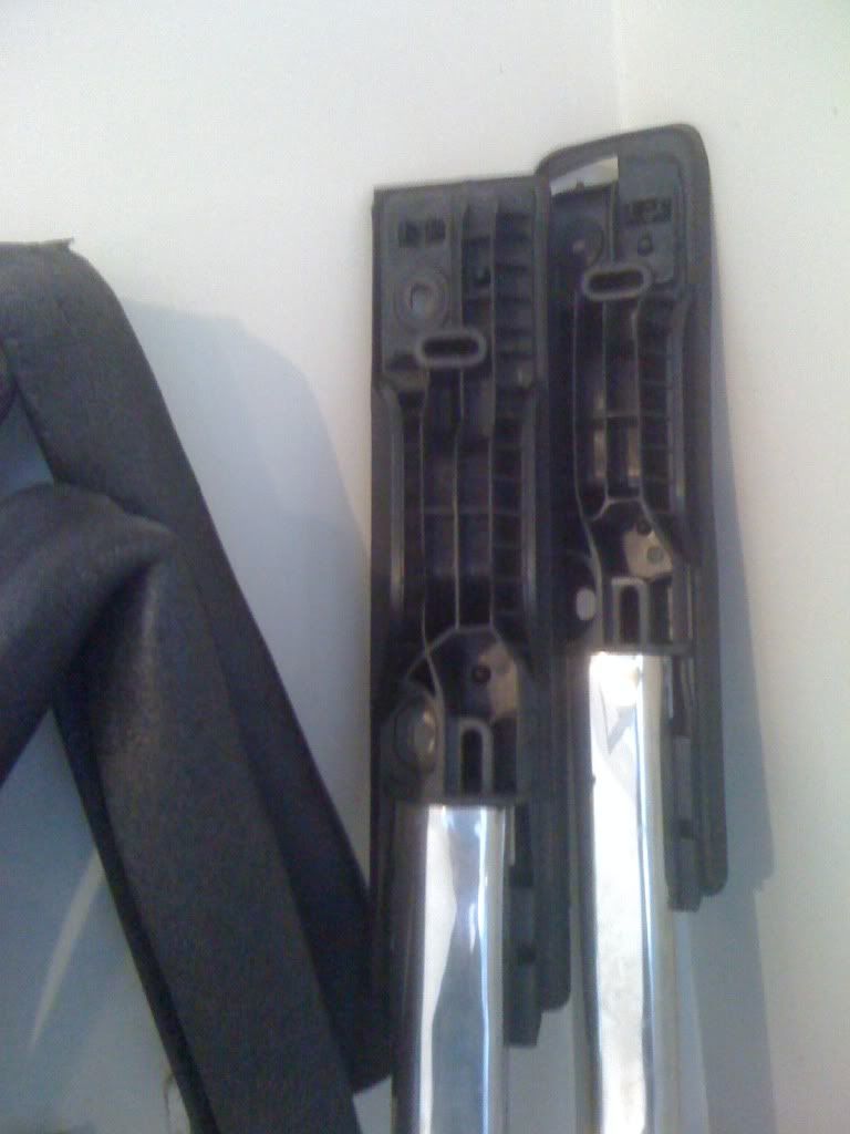

Ok, several of you have replaced your OEM roof rails with aftermarket racks. How did you take apart the black plastic pieces at the ends of the roof rails (as seen in the photo below)?
At a glance, I haven't found anything yet and would like to know before I take them off (since I don't have the best of luck with hidden fasteners) sometime in the next 2-3 weeks.
Thanks for any assistance ya'll can provide.

use a prying tool to get the piece to pop up enough to get your fingers under it and then just pull up...there are only 2 fasteners that hold them in if i recall correct...not hard at all...

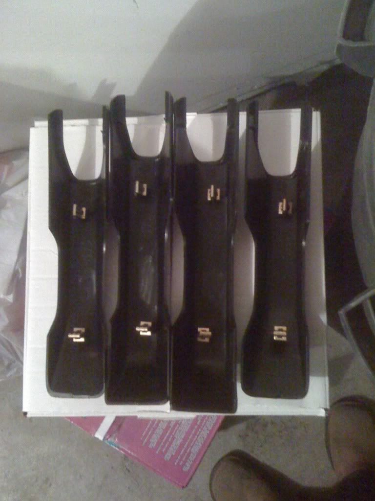

I'll take a quick picture of the clips holding it in place when I get home tonight so you know exactly where to pry :)

Hope this helps. It is actually quite easy to remove them. You can give it quite a bit of muscle without having to worry about damaging anything.

Just pry up in the back side where the rail goes in to the cover :wink:
There are only 2 clips
