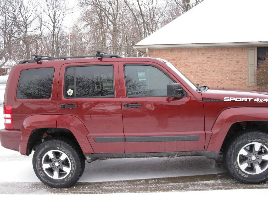

Slippery, everything Devlish said is the conversation I had with my tint installers. Great points to consider. I went with the 35 percent on the front door windows which in Ohio is just below legal (50%) but still not enough to match the rears. Didn't want to draw too much attention from our hard working public servants. Still light enough to see easily through at night.
Here's a shot after the tint was added a couple months back.

Thanks Das...digging those wheels by the way.
