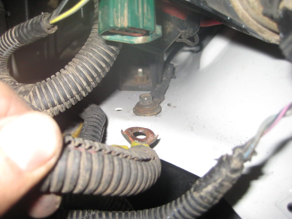

Nothing drives me more bananas then when somebody once had a similar issue but didnt come back to the thread with the fix. I started troubleshooting a little further and found that the horn and fog lights were specifically what set off the wipers. Since the KK obviously didnt do this before the accident I figured I would start with the most likely problem area. I proceeded reaching my arm down and disconnecting one of the wires to the horn and when I pressed the horn button the wipers didnt move, I knew I was on the right track. I went ahead and removed the grill and driver side headlight. Started following the wire bundles from the horns and fog light socket, low and behold I found a ground cable that was disconnected. Hooked it up to the nearest grounding spot. Boom. Fixed. Stupid body shop. :banghead:

All I can say is wow :shock:
One disconnected ground caused all of that :shock: :shock:

I work on aircraft avionics. Ive seen bad grounds and floating grounds cause some of the craziest write ups ever. Theyre usually also the hardest to troubleshoot. This was pretty ridiculous though.

I hope you cealned the grounds ups before attaching it again.
It looks rusty...
It looks rusty...
i took some sand paper to the contacts as a matter of fact. it was copper though, not really rusty.
