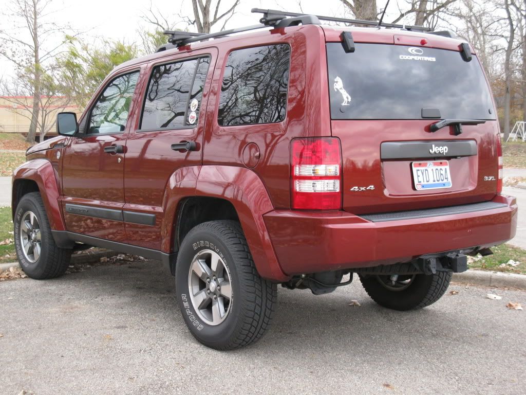

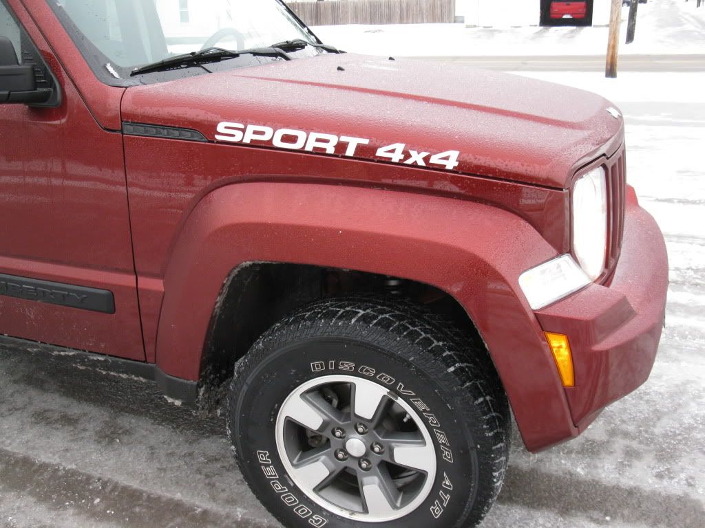

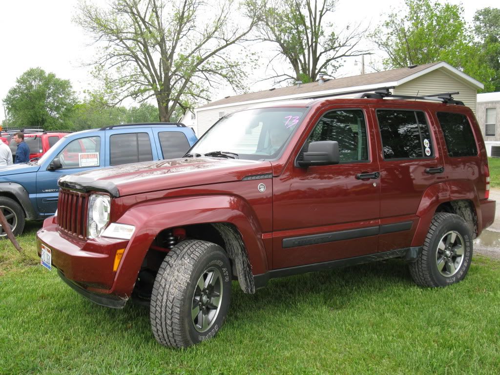

Been running the 255/70's for awhile now. I haven't had any issues with them with maybe the exception of a minor rub at full steering lock. Don't usually find myself in a situation that I need full lock though. Rather do a 2 point turn and save the stress on the hardware. Wheel well clearance is fine front and rear. I'll add that I also have a mild lift since you didn't include that in your post. Here are some older photos of the 255/70's I have. Hope this helps.

The photos helped a bunch. It looks like at the rocker panel the tires stick out about 1" or so. Am I seeing this correct?

yes, at the lowest part of the panels the tires are slightly exposed, but they (the tires) get completely sheilded by the fender bulge as it flares out over them.
This more recent photo has a little better angle to show the bulge of the flares reaching out over the tops of the tires. The sliders kinda block the view of the lower section by the rocker panels though.
