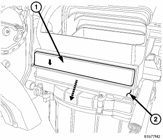

PostPosted: Mon Mar 30, 2009 6:59 pm
Drop the glove box down and look for a panel that says air filter
From the FSM
1. Remove the glove box bin (refer to 23 - BODY/INSTRUMENT PANEL/BIN-GLOVE BOX - REMOVAL).
2. Disengage the two retaining tabs (1) that secure the particulate air filter cover (2) to the passenger side of the HVAC housing (3) and remove the cover.
3. Remove the particulate air filter (1) from the HVAC housing (2) by pulling the filter element straight out of the housing.

If ya'll are talking about just changing the filter in the cabin air filtration system that comes with Premium Group II, then it is easy. I took a couple apart at the dealer while standing around before I got my KK. Just drop the glove box down. There are little tabs on each side. Then you can see the assembly Digger posted an image of. You can pop it open, slide out one filter, then you have to slide the other filter that is next to it over to slide it out. Then just repeat the procedure in reverse to install new ones.
If you're talking about installing the cabin air filtration system on a vehicle that does not have it.....well, the official Jeep instructions show you have to remove the entire flippin' dash assembly to do so. I may be getting back in a couple weeks with an alternate approach..........
