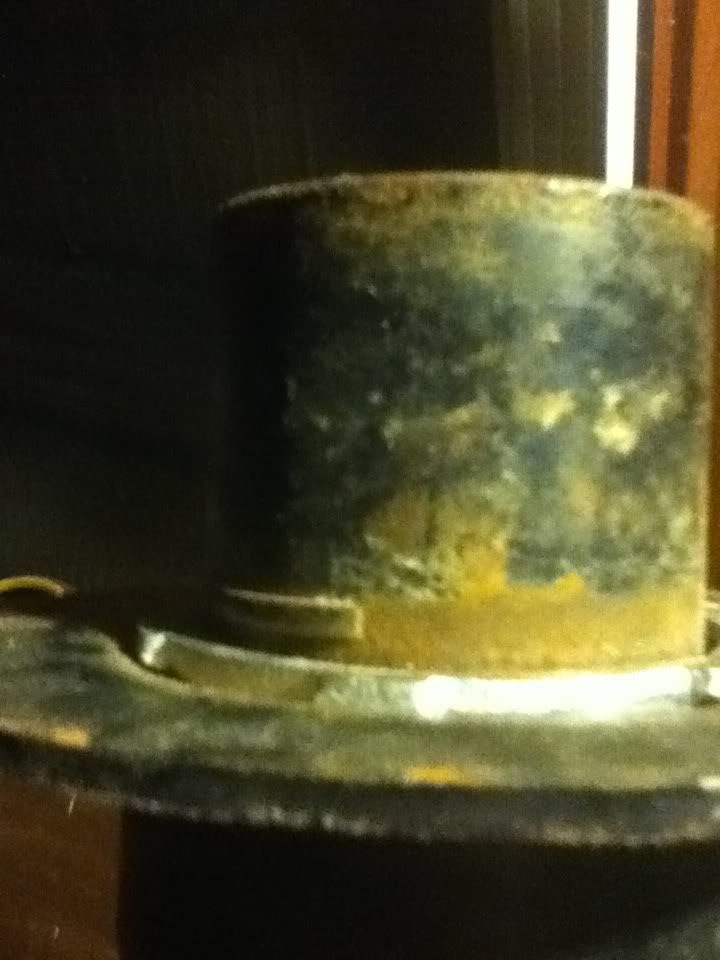

If you want to use conduit nuts here is a little trick
Since we use them mainly just for measurement purposes, here's a little trick. If they slide up over that little shoulder on the bottom of the shock put them in a vise and squeeze them just a little bit so they just go up over the shock. Position them so the narrow part goes where the shoulder is, this way they won't slide up over. Also when using 3 tape them together so they're not falling all over the place, makes it much easier.
Don't share any of the above, we'll keep it to ourselves :ROTFL: :ROTFL: :ROTFL: :ROTFL:

So from where that lip is on the strut mount is where the Clevis lift should start?
2010 Renegade, Salsa Red- selec trac II- daystar 2 inch lift- clevis lift- skyjacker rear shocks- 265/75/16 duratracs- K&N drop in filter-
 Post subject: Re: Questions about conduit lifts and Iso lifts.
PostPosted: Fri Oct 26, 2012 3:25 pm
That lip is where the shock would normally slide down into the clevis, so yes from it you would want to use two or three conduit nuts to give you the lift you want.
They have allowed the conduit nuts to slide up over in the one pictured which would throw off your numbers somewhat
Would it be easier to just make some markings instead of using the conduit, like just make a half inch mark from where that grove sticks out and attach the Clevis at that point on the strut mount.
