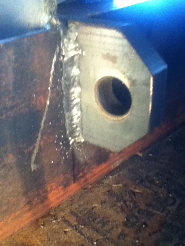

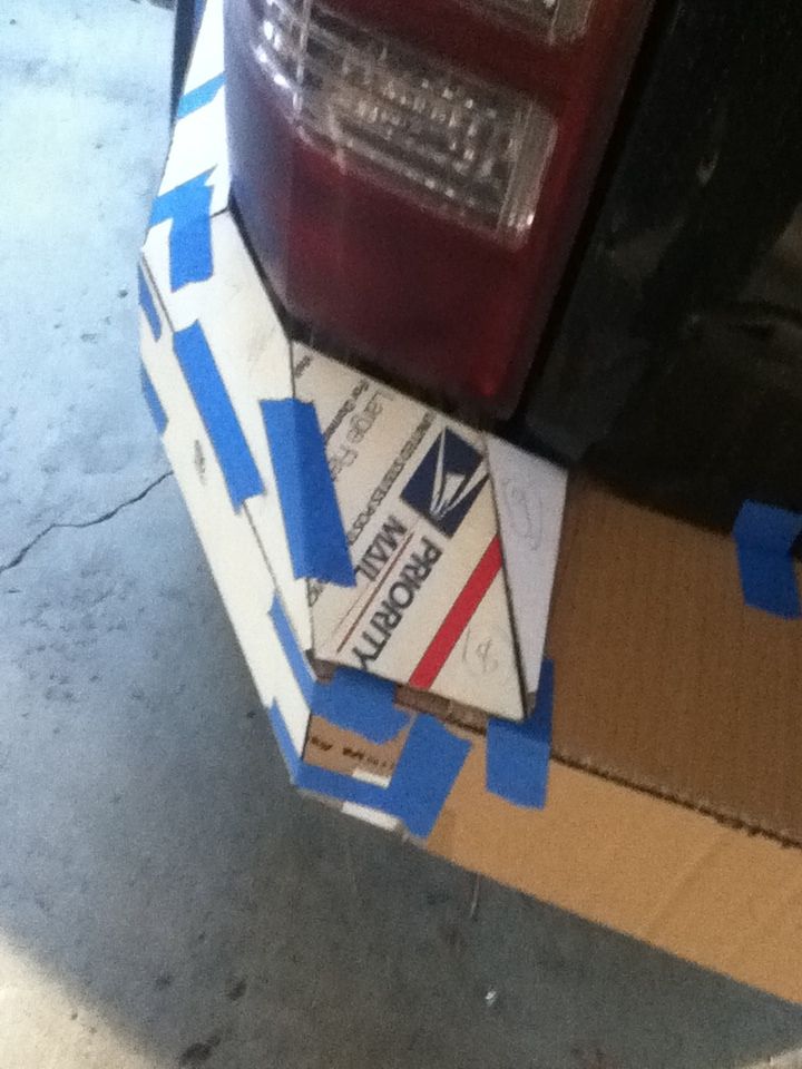

Ok here we go again.
Huge rear crossmember to work around.
Cardboard mock up. (missing the lower lip)
Some pieces cut and tacked up.
Updates as I work on it coming soon.

Made good progress today.
More peices tacked and bottom lip mocked up.
All tacked together, just missing a couple small peices.
