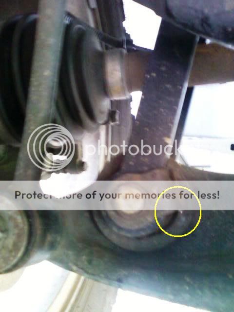

My new front clevis fork was also a little loose, so I added fender washers there(what I had on hand). But if you do this, you will need to make sure the tab on the bolt does not touch the washer, or it will squeak and make you crazy. :banghead:
Bent the tab out 1/16", problem solved. :BANANA:
