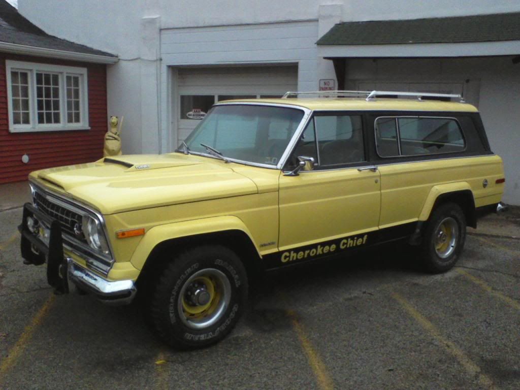

I picked up the KK today from Jeff Daniels Jeep Customizing http://www.jeffdanielsjeeps.com/jd/. These guys have a great shop! There were all sorts of lifted CJ's, TJ's XJ's, and this awesome beast parked out front:

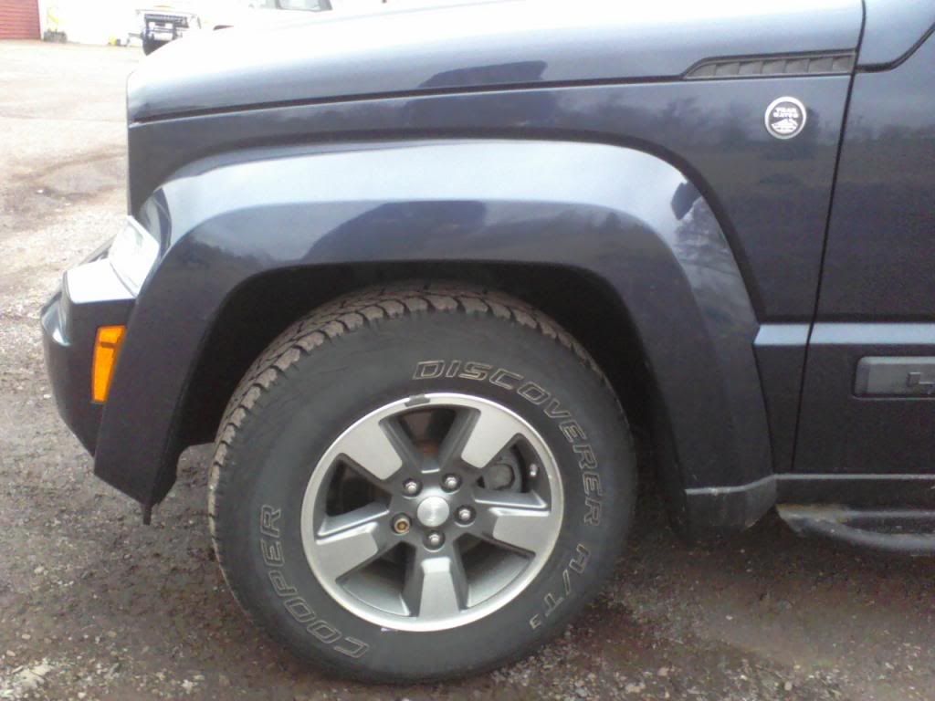

The front wheel well:
Yup, pretty sagged! The measurements from center of the wheel to fender (inner very bottom of the fender; add 1/4-1/2 inch if you measure to the outer curve):
Front/Driver: 17 inches
Front/Passenger: 17 1/2 inches
Rear/Driver: 18 inches
Rear/Passenger: 17 3/4 inches

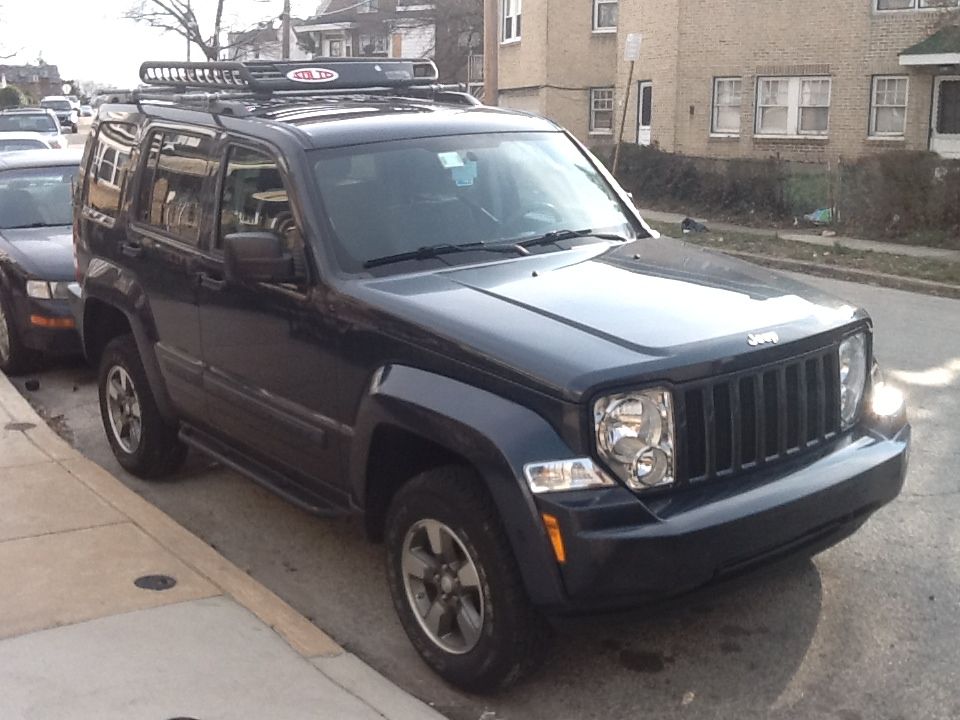

And now (drumroll, please!!!)...
The KK in profile:
The rear wheel well:
Measurements (same method as above):
Front/Driver: 20 1/4 inches
Front/Passenger: 20 1/4 inches
Rear/Driver: 22 inches
Rear/Passenger: 22 inches
The whole rig sits at 6 feet, 10 inches tall from the ground to the top of the roof basket. Got to watch out for those parking garages now! The lift is Hislop's used JBA 4 inch lift kit. The tech at the Jeep shop remarked about what good shape it was in for being a used lift. Thanks, Hislop!
I need to get her some bigger shoes, but the 225/75/R16 Cooper A/T3's don't look too bad because they have a reasonably aggressive tread. There is tons of tread left, so I may run them another 20-30K until they are toast and then get 245's. At that time, I may also give the adjust-a-struts a few turns to get the nose up a little higher. There is definitely a rake to the KK as it sits now.

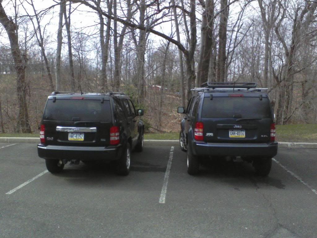

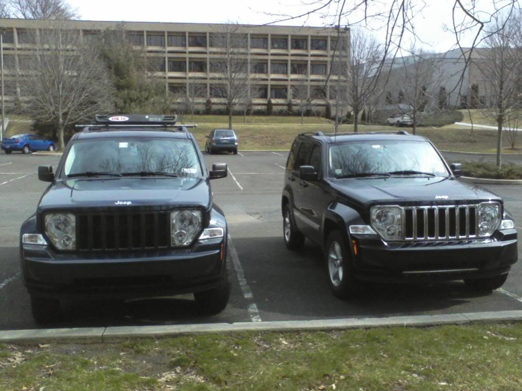

Here she is next to a stock KK at work:

Looking good!
Are you going to leave the front that height or adjust to match the rear?

Looks good! I know it of was me I'd adjust the front ASAP to get rid of the wake rather then waiting for new tires. I really hate having a rake in most vehicles, but I know some are into it.

Thanks! I am ready to get in it and drive it to Moab tonight... actually, I can't do that just yet, but someday I will! :SOMBRERO:
It drives really nicely too. The bumps on the highway aren't as harsh as they used to be. And I like being on the same level with pickup truck drivers. :JEEPIN: The lift is solid-- no funny noises or vibrations. The installers did a nice job, and it is a quality kit to begin with.
I am wondering about the stance/rake. I do think the front would look better with a little more lift to match the rear, but I don't really have the $$ to spend right now on another alignment. I actually don't mind it too much. I wonder if the installers left the front lower to reduce wear and tear on the CVs?

Possibly or they just didn't adjust the front. 20.25 inches up front is what 1.25" lift? Or is 18" stock? Either way save you're pennies this week and crank up the front lol

Either way you're goung to need another alignment after it settles in.

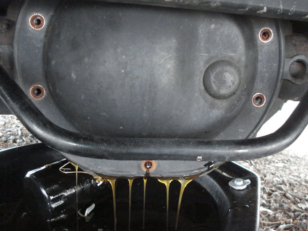

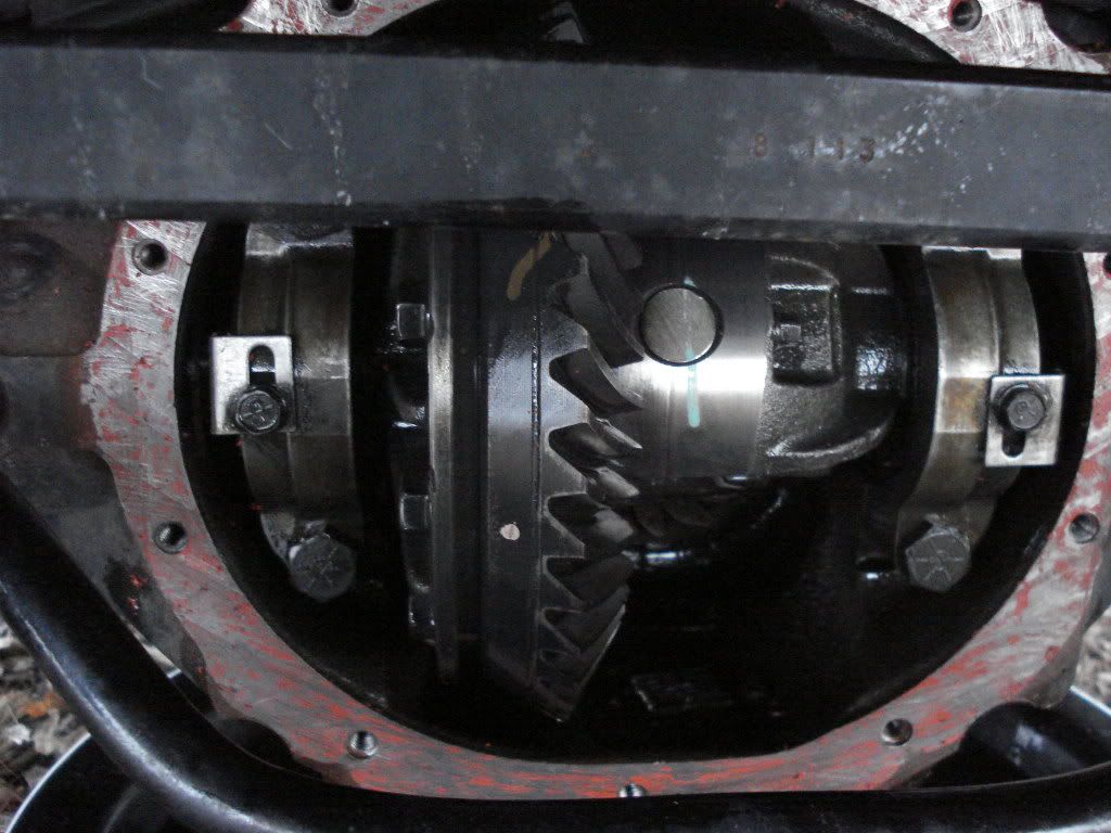

Changed the rear differential oil. Looks to me like it still had a decent gold color to it. Felt pretty nice after the test drive.

Nice. I've been wanting to do that too, so I bookmarked Digger's instructions. I also bookmarked MtnLuvr's how-to for extending the breathers.

Thanks. Can you feel an improvement after changing the diff oil?

Feels a little more peppy and responsive. Could just be in my head. As far as I know, this is the first time it's been done. My tank is close to empty, so maybe it'll improve mileage very slightly.
